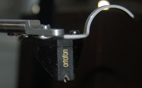

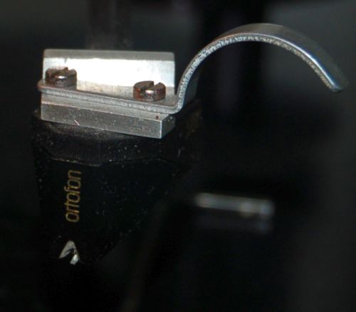

Here's a picture of the tonearm and fingerlift. You can clearly see the bolt and nut used to hold the fingerlift in place. The bolt is too long, leaving no room for the cartridge to be mounted flush under the tonearm.
ADiG
hansdejong
Re: Need helping mounting cartridge in WT Classic tonearm
« Reply #4 on: 17 Jan 2016, 12:46 pm »
Thanks. I checked the manual on Vinyl Engine, and although it has a drawing in it with both ways of attaching the cartridge underneath the tonearm, it isn't described in the text itself. There is no explanation for, or mentioning of benefits of, mounting the cartridge off-centre with one bolt only.
The described way of mounting the cartridge says that the fingerlift should be positioned between the toneam and the cartridge, but this doesn't seem to be possible in my case since the bolt is in the way! Pretty frustrating, this. Are there any members with the same tonearm who can help?

The photos above show exactly how I've always seen it,  including photos on arm box and in arm documentation.
Wonder why the middle hole?   Are there carts with narrower screw spacing than the traditional half inch mount?  If so, maybe to accommodate them?    :dunno:

Thanks! I will try mounting the cartridge like on the photographs!
