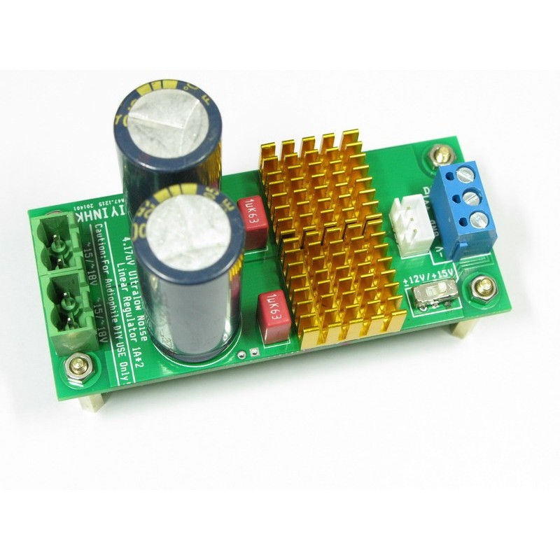

I am using a PCB with two TPS7A4700 4.17uV ultralow noise regulators. It brings me in audio Nirvana with the Piccolo 2. Simply removed the inductors, supply splitter  and 470 ohm resistors. Connected a wire to the ground clamp for the zero Volt reference.
