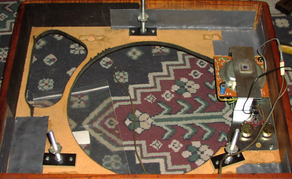

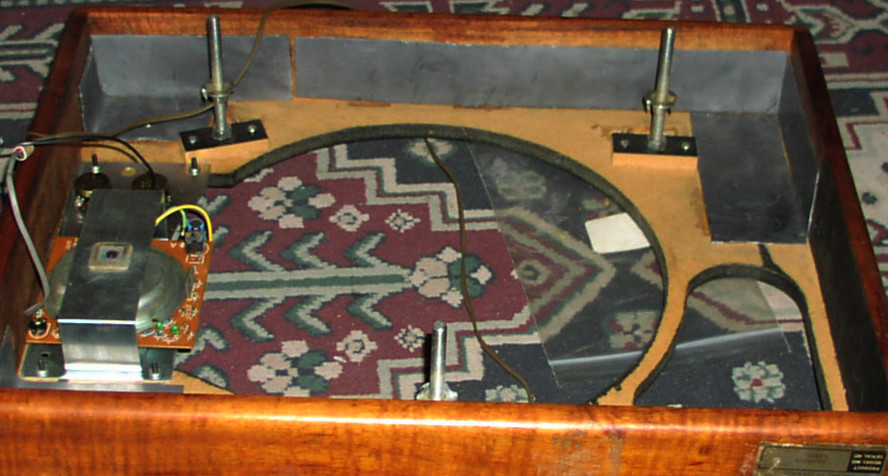

I was figuring out the logistics of all the mods when it occurred to me, there might not be a need to bolt the plinth on the subchassis. If I install a spike where the spring seats were I could have the subchassis stand on its own and the motor/plinth separated from the rest. Sort of like having a motor separate from the table.
Thanks. I've had the table completely torn apart to to figure out what to do with the stretched out springs. The springs in the front hang so low the bottom plate hits the rubber footers. I tried rotating them, front springs back, back springs front, but that wasn't enough.If I can find a way to fix the suspension without a big hassle or expense, I'll take another run at resurrecting the Sota. For now I got it rolling with a cheap cartridge and beat-up MMT arm and gave it to a friend so he can listen to his garage sale vinyl. Russ
