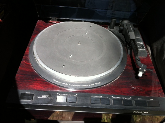

Well....I bought it.    :lol:  I figure I can sell three of the "lesser" tables I have accumulated and just about pay for this one.
Here is a quick shot as it is still in my truck.
Will be looking for a new cartridge or fitting one that I already have.  Jack mentions the Linn/AT 95 is not a good match.  My question now is why and what should I be looking for.  I would like to stay with a mm at this time.  I think I read it is a low mass arm which requires a high compliance cart.  I have one or two that I will list when I get home to see if they will work.
It started up and qued fine but the locate feature took a couple back and forths to go to the end of the record.  On the second start of the record the arm needed a slight nudge to continue.  Third and fourth went fine.  Hoping it will work itself out or a little clean/oil may be in order.

The AT-95e is a pretty low compliance cartridge as AT's go especially compared to the 120e or 440mla.  It will work however with that low mass arm if you want to try it because of the Denon's Q-damping.  If you still have the M91/SAS and the stylus itself is good you might want to look into picking up another M91 body from Ebay and trying that. That stylus should also fit the electronically identical M75 body.

Nice little table.  Not so little really, but compared to its big brothers the 59L, 62L etc, it's little.  If the arm continues to hesitate and is reluctant to go through the motions, you might want to take the bottom off and clean and lubricate the mechanical connections.  I suggest silicon spray which is also used as a cleaner.  If you're turning it sideways or upside down, don't forget to first remove the platter and secure the arm.
The K9 is a nice sounding cart with a balanced sound and yes, compliance is rather low - made for a med mass arm, it's 15cu.  Does bass seem deficient?  If you want a nice 3 mil elliptical replacement that tracks at 1.5g, you can buy an AT92ECD on epay for $21.  Remove the stylus and cut back the plastic sides with a wire cutter.  Works like a charm and if you want, you can remove all the plastic except the plug that fits into the body, for the Clearaudio look.  Before you do this you might want to make sure the stylus isn't glued in.  It should pull almost straight out from the body.

Wondering how this is coming along.  Also wondering about those slots in the mat.  They're for the optical sensor - that cylinder near the tonearm.  This is for determining record size with auto start.  Will the table function at all if the mat is replaced with a regular slotless one?  Some other tables with similar optical sensors go crazy if the slots are covered.  When started, the arm goes back and forth like it can't decide where to land.

All is well with the table.  You are correct about the mat.  I think it would play LP's just fine with an aftermarket mat.  The OM states that if you are playing clear vinyl you may have to rotate the mat 90o to cover the sensors.  Guessing that if both slots are covered the sensors think it is a 12 incher.  Would like to try a herbies mat, one that would fit the JVC and Denon but I think they are different thicknesses, and, I keep buying tables.  :?
