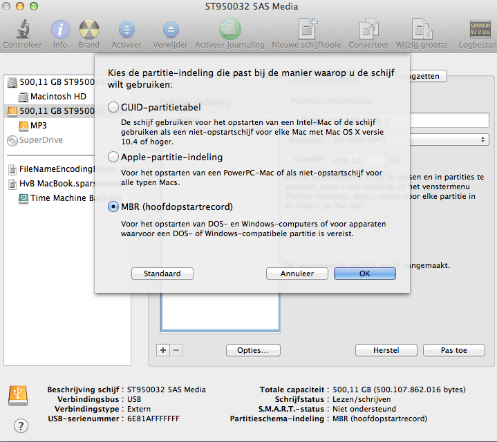

Yep, I had that for a long time, and then found out the drive wasn't formatted corectly. In my case (im on a mac) I had to format the hdd's  fat32, (MS-Dos) using the MBR option.
Unsupported_fs disappeared, working wonders for the stability. If your on a mac, also check the "apple-files". the BDp1 doesn't like those, and getting rid of them really solves a lot of issues. I've made a separate Ac-post about it a while ago: http://www.audiocircle.com/index.php?topic=109332.0
Good luck,
MArius
