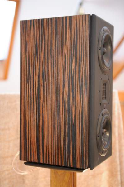

Great work Randall !!
As a novice diy'er I was wondering if you could tell me how you attach
the front baffle to the enclosure ?
Is it removable ??
I can only hope my project turns out half as well...
Thanks for the pictures    :thumb:
The front baffles are not removable. All alignment is done through biscuits. The biscuits are first glued into place in the speaker. Next the glue is applied into the remaining biscuit slots. Before the 2 are assembled a bead of sylicone is applied to the front of the speaker and the two are joined together w/ clamps. Air tight seal!. R.K.

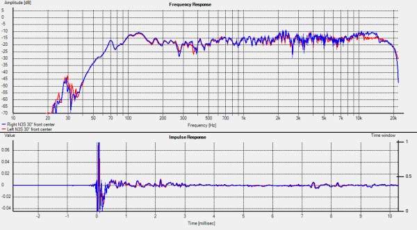

Here are the N3S Measurements from 30" away from the center of the tweeter.
Red=Left
Blue=Right

Thanks for posting the on axis measurements Jtwrace. The two speakers look to be very closely matched.
You newbies should learn something or two from Jt. He knew very little about how to measure over 6 months ago. Now look at him. His perseverance should be revered. He'll measure any transducer that sets foot in his house!
Great work, and the speakers look divine.
Yes they are.
:oops: Well, I did but just not at the level I can today.  HolmImpluse has made the whole experience so much nicer.  It works every time I go to use it.  You are correct, any transducer that comes in, gets measured!  I was hoping to do these outside but time got in the way.  I really wanted to make sure they were a matched pair.

Finaly got to hear them this weekend and I must say I was very impressed w/ what I heard! I knew the speakers were built to exact spec's . Nothing on this build was done in the conventinal manner. There was not 1 tape measure used on this build , nor was it CNC'd . Everything was layed out w/ dial calipers and a compass. Now mind you the N3'S isnt an overly complicated design I went at it w/ the mindset that if Danny had designed it to be layed out to a certain spec that part was going to be cut and installed into the "EXACT" location on the prints. Not off by a few thou or misaligned part no matter how insignificant and I can say it was spot on on the build. The veneer and the finish is just eye candy, the beauty is whats inside the box. Now on to Danny.... Man has this guy got a GIFT! ! ! !
As I said this was the first time I got to hear them this weekend at Jasons and I was blown away by them , I knew I had done my end of the deal w/ the cabinets but what Danny does is ... well I just dont have have the words. I am very excited at the future builds I will be participating in Featuring  Dannys Genius but if this could be summed up in one word to me it would be incredible!
As I said before, this man has a GIFT. R.K.

Nice attention to detail... I like the veneer match on the top and the veneered reveal around the baffle... nicely done! The black textured baffle goes really well with the dark tone of the veneer.
