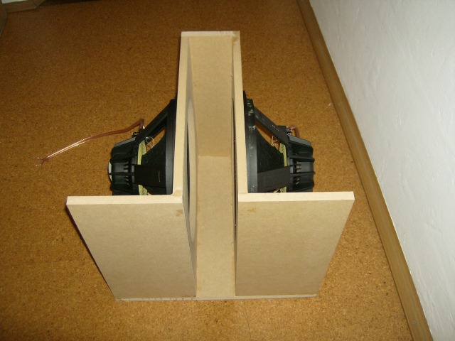

I built a W frame dipole using two 15'' drivers (views with the top removed):
This is the first speaker I built from scratch. This sub was very easy to build, this is a one afternoon project.

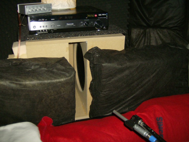

The sub is installed very close to the listening position, just behind the listening sofa , at ear height:
The red part is a blanket that covers the sofa. I temporally placed two pieces of rockwool between the sub and the back of the sofa in order to decrease reflections from the hard surfaces.
The slot is facing the listener.  The slot acts as an acoustical lens that concentrates bass energy on one small spot. Outside this spot, the bass level decreases very quickly, which gives a neighbor friendly dipole sub.
Another advantage of this set up is that there is zero room interaction for the lowest frequencies. Pure bass!

mcgsxr
Re: Neighbor friendly dipole sub
« Reply #1 on: 21 May 2008, 08:08 pm »
Very interesting, I had not thought of that type of install, for that type of implementation.
I look forward both to the objective and subjective details!

Nice curve! I haven't seen that before, no walls on the side?

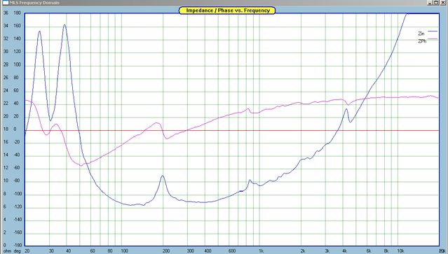

Impedance of the sub only  (no filter/boosting/eq):
FS is 26-27 Hz. FS of driver alone:  about 34 Hz. Strong resonance around 200 Hz.

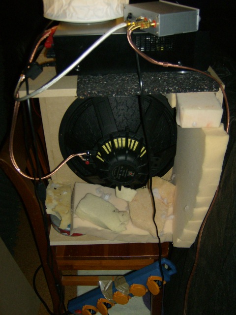

To decrease the 200 Hz resonance, I added pieces of memory  foam inside the sides:

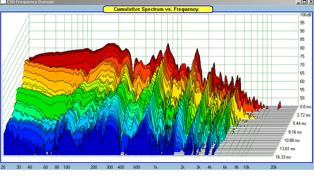

Waterfall plot with memory foam measured at the listening position:
The foam makes a visible difference in the water fall plot around 200 Hz.

Were some measurements taken with the sides removed, or were the photos taken at a different time ?
Have you run it without the sides, and if yes how does it compare/sound ?
I notice the 50Hz blip in the impedance plot which is not noticeable on other responses.  It might equate to a room dimension, but is very sharp and there are not any others similar.  Any known reason for it ?
Cheers ............ Graham.

You have probably noticed slight differences between the FR's. I used two different amplifiers and probably slightly different mic positions . I also used foam for the second set of measurements.  I liked the sound better without the sides. I will redo FR measurements with and without the sides.
The blib is due to the 50Hz AC from the power supply of my external sound card.

1)  I understand the neighbor/SPL objective drove the placement to be right by yer head.
Have you tried with the frame on the floor just for kicks? :hyper: like a foot or so behind the seat.  Basically I'm wondering about sofa coverage rather than single-seat as you've described.   Also because SAF goes up when the box goes down (outta sight)  :oops: . . .
2)  How far is the frame and/or your listening position from the rear wall?  'Apologies if this was mentioned and I missed it.  Maybe not a big factor at the super-nearfield listening distance you are using, but I'm still curious.
This could prove to be an awesome alternative to IB bass!  Please keep us posted on any new discoveries or variations you try!

Here is an impedance plot measured on a single woofer:
I first thought  that my dipole sub was transformed into a bass-reflex because of the two peaks :scratch:.
It seems that the two drivers really see each other although they are not placed on a air tight enclosure.
Bruno

I havent' tried with the sub on the floor. On way to increase sofa coverage is to rotate the sub 180 deg, then the slot is facing the back wall. In this case, the amplifier volume must be increased and the low pass filter must be steeper because of the relatively stronger 200 Hz resonance.
the listening position is 1.5 m far from the back wall and the on the sub is 0.5 m deep. I have a small listening room. I would not placed the sub on the floor between the sofa and the back wall because it would increase cancellation of the dipole. A better placement would be the middle of the room, far away from walls and corners. I don't know when I will try another position for the sub.

I know you filter out the Ripole peak around 200Hz, and this must be related to the cabinet rather than a driver dimension.
Does taking the sides away help in that regard ?
It also occurs to me that if a Ripole was shrunk in size - as for say 8" drivers - then that 200Hz resonance might be shifted away from bass frequencies - to around 400Hz - and thus further away from the wanted LF working range.  Of course more 8" drivers would then become necessary to match the 2x 15" cone area, though with a potential to be more efficient too.
Cheers ....... Graham.
Hi Graham,

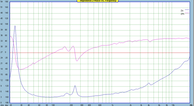

I remeasured the impedance plots with and without sides. The two drivers are connected in parallel.
First, without side wall.
Second with the side walls. Note that my side walls cover only 50% of the surface of the sides. Unfortunately, I don't have full size walls to try.
We can see now two resonance peaks, one at about 180 and another stronger at about 240 Hz. Also, the main FS decreases slightly in intensity (41.5 Ohms) and frequency (24 Hz)

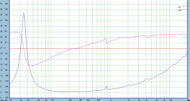

Finally, without the sides walls but with plenty of memory foam attached to the walls (I posted a pict earlier in this thread)
The intensity of the 200 Hz resonance peak is lower. The FS decreases in intensity (40.5 Ohms) and frequency (24 Hz) .
And now yet another strange plot. The setup is the same as the previous plot: memory foam and no sides. But this time I connected the two drivers out of phase!
There is no more 200 Hz resonance and I don't understand why. :scratch:
The FS is about 34 Hz and 45 Ohms. This  looks like a free air measurement.
There is a new resonance at 850 Hz.

"There is no more 200 Hz resonance and I don't understand why."
Because the cavity is not pressurized now.  More of a free-air result measurement is what you'd expect, and that's what you have.
Dave.
