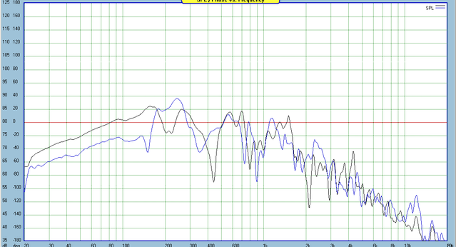

Hi Dave and Graham,
if the front cavity is radiating the 200 Hz resonance, how do you explain the following?
1)  I measured much less resonance from the front cavity than from the sides
the black line line is the FR at the listening position when the front cavity faces the listening position whereas the blue line is the FR when the side cavities are facing the listening position.
2) adding foam in the side cavities decreases resonance.

My comment was only regarding your out-of-phase impedance measurement.  That's obviously not a mode you would use so it shouldn't be of concern.  In that case the two woofers are always moving in the same direction so there is no pressure created in the cavity and thus you aren't "exciting" it.
I think you might try taking some close-up measurements to better define the radiation pattern.  I'm not sure it's as directional as you think it is.

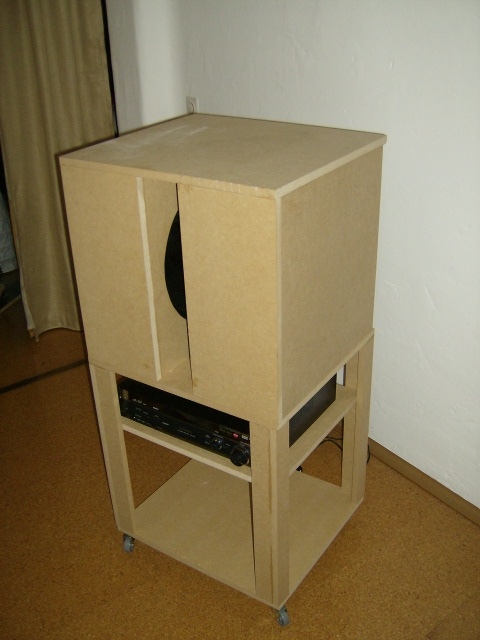

I built a stand for the sub.
This is a small table with wheels. A shelve holds the electronics.
Bruno

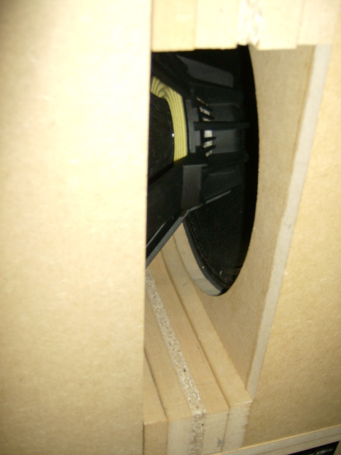

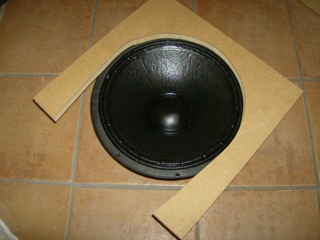

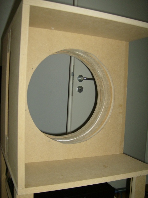

Filling the small cavity
« Reply #26 on: 17 Jun 2008, 03:58 am »
Here is how I filled the small cavity with incompressible material while still allowing air flow.
I built a U shaped piece of wood
I inserted the U inside the small cavity
Bruno
Bruno
This little table with wheels is very convenient. Unfortunately, it is not as stable as the chair I had before. I noticed that bass was not as good:  slower. The solution I  tried yesterday is to place a heavy stone on the top of the sub. Works.
Bruno

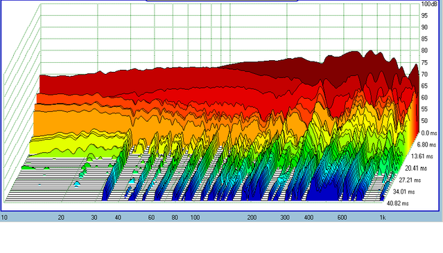

Hi Graham,
you suggested two times to try a flat mounted OB alternative and to compare the sound to the ripole. It is a good suggestion but I haven't had the time to do so. What I did, is to measure the waterfall plots of the driver alone and mounted on the ripole. Here are the results:
1) The driver is placed on a small speaker stand and the microphone is placed very close to the membrane. The idea is to simulate the results one would obtain if the driver would be placed on a flat mounted OB.
2) Two drivers are mounted on the ripole and the mic is placed in front of the small opening. The small cavity is filled with the U (see my post above) and full length side walls are used.

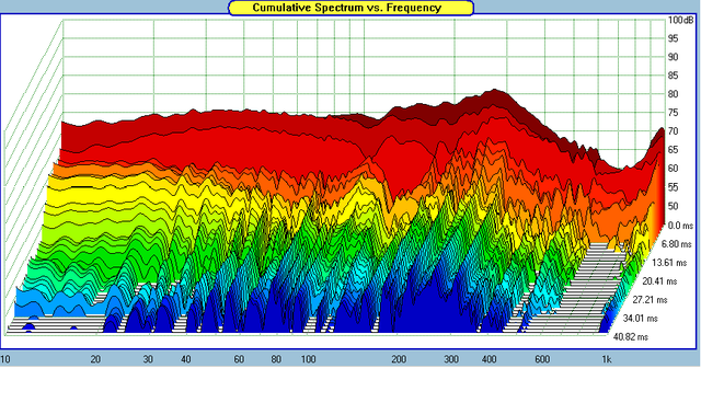

The second plot is certainly noisier than the first plot. The ripole shows longer decays even at lower frequencies.
Note that I am not completely confident in these measurements. I have read elsewhere that WF plots are not reliable for low frequencies.
What surprises me is that the main resonances (34 Hz for open air driver and 22 Hz for the ripole) are barely visible.
Bruno

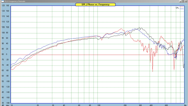

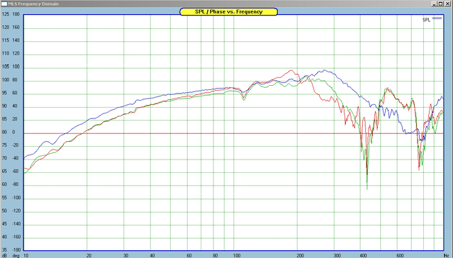

The plot below shows the effect of the sidewalls and the "U" on the FR of my sub.
The mic is placed just in front of the small cavity.
The red line:  no side walls, no U.
The green line: + full length side walls.
The blue line: + full length side walls  + U
Adding the "U" increases the 20 Hz level by 4 db.
Bruno

I cannot comment on the waterfall 'ripples' because I do not know the how and why of their origins.  However a 4dB relative increase clearly shows at 20Hz wrt 100Hz for the Ripole mic compared to single driver mic measurement.
Resonant development requires 'Q' and a steady sine drive waveform continuing for more than one full cycle.
With low Qes LS drivers and SS drive the 'one-note bass' resonance cannot develop.
Insert series R or use a SET amplifier and it will though !
So the front 'U' insert improves LF output and gets rid of the notch at about 420Hz.
Wonder what rear 'U's would do ?
Or rear aperture damping - maybe reduce the new 270Hz SPL peak ?
Rear damping might reduce some of the Ripole waterfall 'noise' too ?
Cheers .......... Graham.

Here are the measurements of the sub with a Linkwitz configuration.
Frequency response:
The black line: + full length side walls  + U + Linkwitz configuration
The black line shows clearly that the sound level in a Linkwitz configuration is decreased. However, it is actually not as strong as shown on the plot.

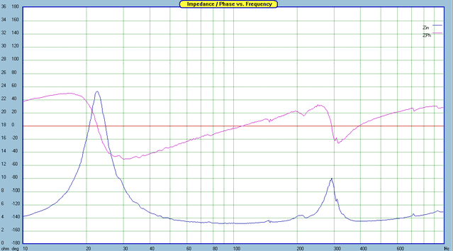

I made a mistake when mounting the driver in the Linkwitz configuration. The driver hole was slightly too small and there was an air leak. I measured afterwards (after fixing the leak) that this leak accounts for a loss of about 2 db at 20Hz and 1 db at 100 Hz. Still, even taking the effect of the leak into account, there is still a slight decrease of the output level.
This is the impedance plot of the sub described above (see my post above):
The secondary resonance moved to a higher frequency, almost 300 Hz.
The waterfall plot (not shown) looks slightly better in the region < 150 Hz.
I don't know yet which configuration sounds better.

« Reply #37 on: 1 Jul 2008, 06:57 am »
Hi Bruno,
Clearly running drivers face to face with your centre 'U' section improves output and reduces cavity resonances.
I am tempted to ask what it would be like with 'U' sections at the rear as well, but both the impedance and SPL plots already look pretty clean.
Cheers ........ Graham.
