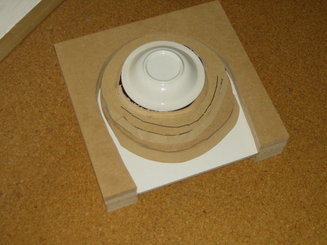

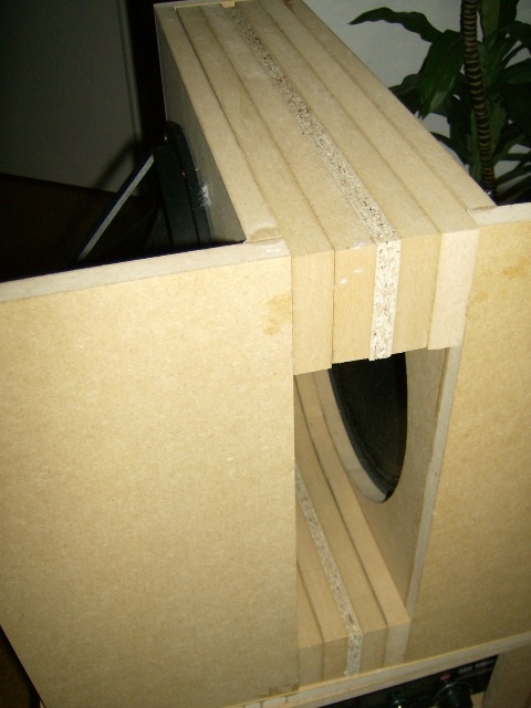

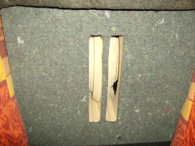

I have decreased the inner volume of the small cavity. Here is how the sub looks from the listening position:

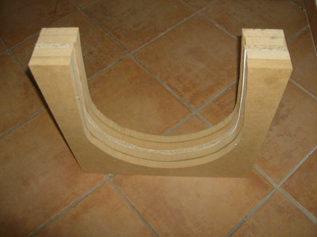

Here is what I built. I started from the "U" that I described in a previous post:
I added several layers of wood and two plates:
Then placed the new "U" back  inside the small cavity
The idea is to decreased the volume while still allowing air flow.
I will show the measurements in the next posts.
Bruno

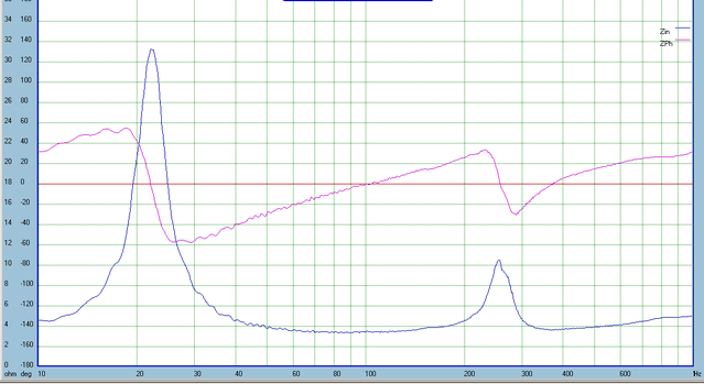

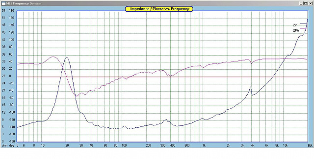

Here is the impedance plot:
The main frequency of resonance is lower than before (about 22 Hz).
The troublesome dipole resonance has shifted to higher frequency: about 350 Hz. That's 150 Hz higher than my first version of the sub that did not have a "U" inside.
More measurements are coming.
Bruno

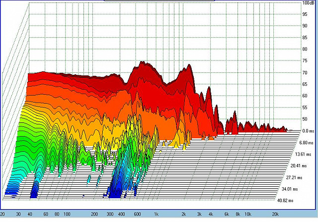

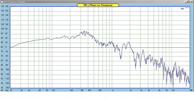

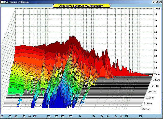

Measures made with the mic placed inside the small cavity
Frequency response:
Waterfall plot:

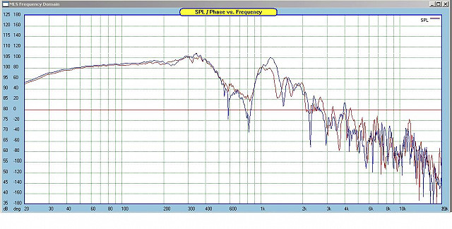

Measures made with the mic outside a few inches in front of  the small cavity (more or less the listening position)
Frequency response:
Waterfall plot:
30 Hz is at about -5 db from 100 Hz without any boost.
The  resonance at 350 Hz is mush stronger when measured outside than inside the small cavity for a reason I don't understand.
Bruno

Hi Rudolf,
I will try to make it clearer (I should have taken more pictures while I built it).
Let's start with a view from the sub with the "U" installed:
The point of view is similar to the one I used for the picture (sub covered with felt)  I presented three or four posts before this post.
Now , in the middle I glued vertically a white board that hermetically divides the internal cavity into two identical parts. The two drivers are still placed at the same position: they face each other but do not see each other because of the white board.
The next step is to fill some of the empty space in front of each driver with a kind of cone made of wood and a plate (does not look very nice I admit). These cones are glued to the white board. They face the black driver cones. A few centimeters of free space is left between the cones I made and the driver cones.
Hope this is clearer.
Bruno

Thanks a lot Bruno,
now I DO understand. So it is becoming some sort of compression driver.
Have the last measurements been done with the cones in place already?
