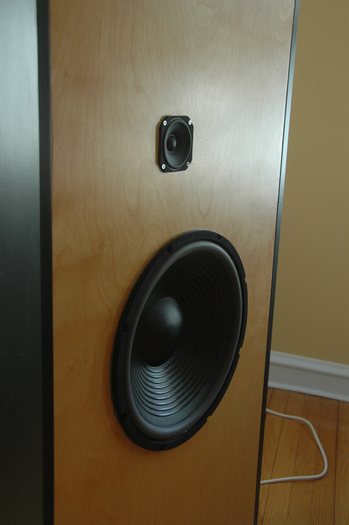

Here are some shots of my Ultras to bump this thread.  The fronts are finished and look pretty good but the backs are still unfinished so there aren't any shots of the rears.
Overall it's been a great project.  They sound nicer than they have any right to sound for the money spent and they have a very pleasant sound signature.  Great recordings shine but you won't get ear bleeds from the poorly recorded stuff in the collection.
The only issue with the build was the quality of my woodworking.  The hole for the 3 1/2 inch driver was just a bit too big and there was a very slight gap between the driver and the wood.  This did reduce the quality of the midrange and high frequencies but a bit of rope caulk around the gap fixed the problem.
The bass was always good but with a few gear improvements the bass is now really amazing.  Tuneful, articulate and plentiful.  Folks ask if the subwoofer in the room is on but it's not.
They are a bit laid back sounding with the stock crossover and it's been fun making modest changes to suit the changes in audio gear and mood.  In my room I seem to like a bit more output from the high frequencies so there are a few resistors tweaked.
It's a good project.

Thanks Motosapien.  They don't quite look that good in person but the light was hitting them just right the other day so it was time for some photos.
Bass is pretty amazing.  There is a lot of it and it has real texture.  Upright bass has the right tone and texture and the 15" drivers move enough air so you feel it.
There is enough bass that placing the Ultras in the room is sort of critical.  The bass can be very loose if the speakers aren't in the right spot so it can take some time to get them setup correctly.  Once you hit the right spot and the right toe in they'll really let you know.
Placement of the smaller Manzanitas was also pretty critical but there seemed to be a bit more wriggle room with them.  One or two spots would both sound good and it was just a question of personal preference on which spot was "best".
Changing the crossover resistors will also change the bass output of the Ultras so they're easy to tweak.  I still haven't quite decided which settings are "best" but have been leaning pretty close to John's specs most of the time.
The Ultras are significantly better sounding than my Manzis but my Manzis are the original version with the 1st tweeter.  I suspect your Manzi build with the full range driver is up a few levels from mine.  So even though I've got both speakers I can't really do a good comparison between the two builds.  But based on my two builds, IMHO, the Ultras do put out more bass than the Manzis.
