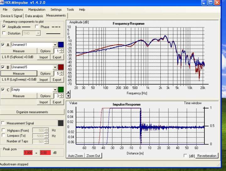

Some more measurements...
Here is the first of more Holm in room snaps for the Ultra.  This one shows the GRS 15 on baffle at 8' on axis with a MLS Sq noise sweep (reddish brown trace) and standard log sweep.  No crossover inductor.  The lower end below about 100 Hz is not acurate, as in too smooth.

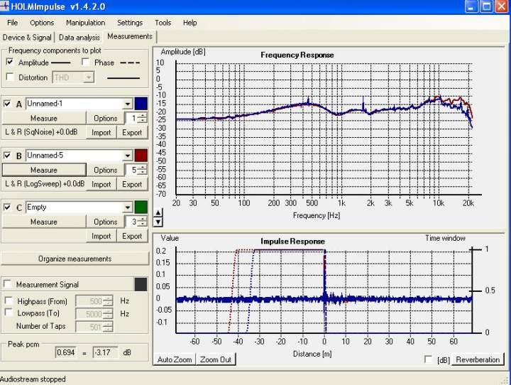

JBspeakerman
Here is the Vifa on Ultra baffle, no crossover.  Again, the very low end is not representive of reality.  Blue trace is log sweep, Redish brown is MLS Sq noise.  The spikes at 450 & 1.8K are anomalous noise.
panomaniac
Thanks John for the graphs.  It would be nice if you could repost them not gated, but maybe at 1/12th octave smoothed.   The gated measurements always confuse me.   :?

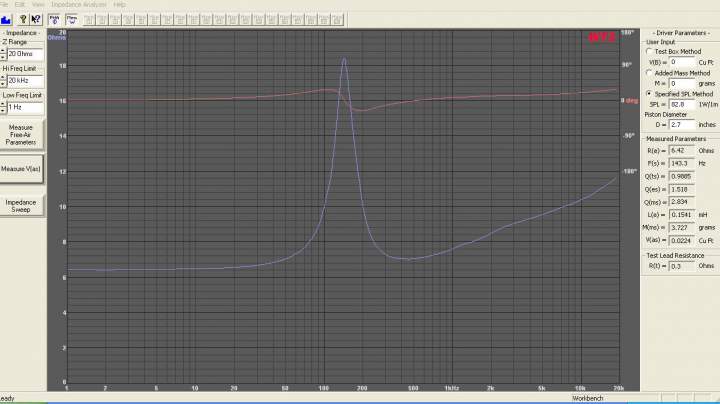

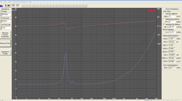

JBspeakerman
Pano
Do you want the T/S values with the drivers mounted on the baffle or free air?   T/S values or complete WT3 sweeps & info?
panomaniac
I think for Martin's sims free air is needed.  I don't know if he needs the impedance curves (or numbers) but I guess it couldn't hurt. The exported numbers could be zipped and posted.
Post the free air T/S and let's see what Martin says.  The DCR of your coils might help, too.  Thanks!
MJK
  • Posts: 472
    • Quarter Wavelength Loudspeaker Design
Posts 61 and 62 contain T/S parameters for the drivers. I checked them for consistency and everything matched. Putting these values into my original sims did not change the results significantly. The dominant contributor to the dip in the middle of the SPL curves is the fundamental crossover design, not the driver T/S parameters. I don't think this set-up will sim or measure flat, but if it sounds good who cares.
