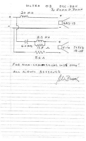

OK, here is my crude pencil sketch schematic for the Ultra OB.  I will try to talk Pano into posting something way more professional looking after he returns from his swamp trip!!
The configuration shown has been listened to extensively with a wide variety of music and amplifiers.  The amps included a 5 wpc KT88 SET, 15 wpc KT88 SEP, 30 wpc class A PP EL34, 30 wpc Virtue II chip, 38 wpc PE Dayton chip, Rat Shack 75 wpc receiver, Sherwood 110 wpc receiver and 200 wpc Musical Fidelity A308.  The stated out put power values are what I have measured into a static 8 ohm load and do not necessarily jive with advertised ratings.  After all of that, I arrived at what you see.  For most of the above, in a 20' X 25' x 8.5' room with carpet and furniture, the tonal balance is fairly neutral except with the PP transistor receivers.  The receivers are a bit dull and can benefit from a lower pad resistor, say 4.5 to 5.0 ohms.  One of the fun parts of this design is you can play all you want!  Some may want to experiment with attaching felt strips in various places, like on the inside of the wings adjacent to the Vifa and or the GRS.  Or on the baffle face.
This speaker has excellent and very full lower midrange.  Clarinets and such have a lot of body while maintaining surprising clarity.  Some may feel TOO much body.  To adjust this, a reduction in the high pass capacitor to around 5 MFD or so may be what you may find preferable.  I have made some previous comments concerning positioning distance from the rear wall.  I prefer about 36".  Some may find a bit of toe in toward the listener will have a positive effect imaging.
Make very sure your baffle structure is tight.  If you have a signal generator run it up and down until you eliminate all rattles.  Seems that the 45-70 Hz region is most prone to producing unwanted baffle noise.  Those with out a sig gen can use a test CD (warble tones and the like).
I will be interested in hearing back from those who build this project.  I truly feel most will be surprised at how good this speaker is with in it's out put and efficiency limits.  It is very revealing of amplifier and source quality.  What I found interesting during the audition process is that the Ultra easily demonstrated amplifier quality differences.  Very uncommon for a speaker of this simplicity and low cost.

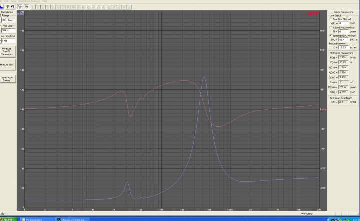

If I have done this correctly here is a snap of the Ultra Impedence and phase characteristics via WT3.

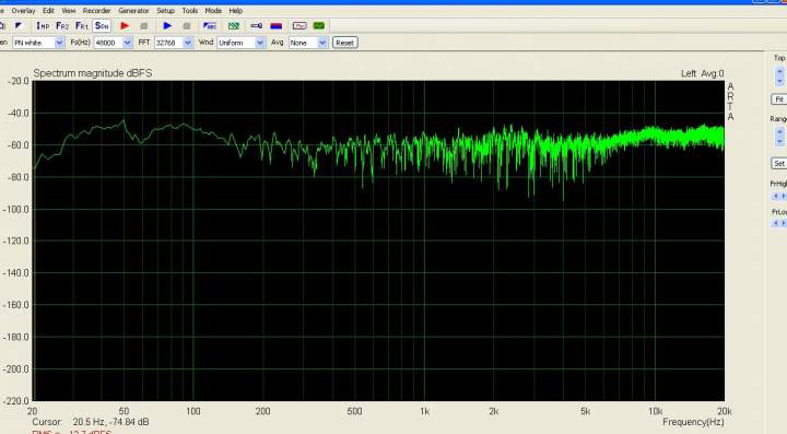

Here is a marginal resolution ARTA measurement taken on tweeter axis at approximately 8'.
I will work on a higher resolution snap tonight.  There is a bit of noise on both ends of the spectrum and anything above about 16K is not representive, same thing below 40 Hz.  You can see some baffle face reflection issues around and just above 2K.    And you see some wall reflection - room issues right at 50 Hz as well as some baffle buzz suck out at 60 Hz.  Will work on eliminating the Baffle noise before I take any more data.  But all and all flater over all than it has a right to be.  Will work on some Holm measurements next.

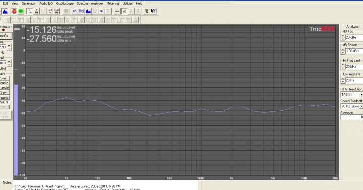

Here is the True Audio sweep.  1/3rd octave is what my version does and makes things look a bit better than they usually are.  But, I have found the rounded True Audio frequency curves tend to jive with what one hears in the listening chair.  True with mono or dipole sources.
Will be interested in what others measure in various venues.

Thanks for posting actual FR plots. The only thing I enjoy more than measurements matching listening impressions is when reality (i.e. measurements) disproves a bad simulation.

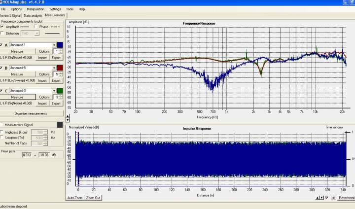

More observations.
Some may prefer the running the Vifa in reverse polarity.  This does provide a flatter on axis response.  However, it is a bit hotter to my ears on the upper end so for some listeners a little more pad may be in order, say 6.2 ohms or so.  There is some improvement in the area of midrange detail, but the mid bass seems to fatten up just a bit.  Need to experiment with Vifa polarity VS. rear wall distance and report back on that.
BTW, Jarome, thanks for sending your sim data via PM.
Each polarity has it's own sonic signature.  Both sound great which, givin the simulation differences is quite surprising.  It will be interesting to get feed back as to which polarity is most popular.
Using the Holm measurements you can really see quite a difference.  Will post some snaps later as I have the time.

Nearly all the crossover layout decisions for the Ultra were made based on SQ.  Just wanted to see where my ears would take me.  Found out long ago using most of traditional monopole crossover layout theory with OB designs to be a waste of time.

Hello all
Here is the Ultra Holm combo plot of Vifa in phase (showing the classic crossover frequency summation dip) and out of phase exhibiting classic phase correct flat summation band pass behavior.  Looks like we have a classic 2nd order response.  There are of course room behavior artifacts, as well as compromised measurement technic issues.
But... I think it shows the crossover component values to be spot on.  How did we end up with what looks like 2rd or 4th order roll off symmetry on the woofer low pass with just a single inductor?  Same goes for the Vifa with it's single cap high pass element.
This data was taken at 9' prox on Vifa axis at a couple of volts input.  Baffles toed in about 5 deg. relative to rear wall with baffle to rear wall separation at 36".
Again, I must emphisize that both solutions sound quite nice and reveiling.  In phase, overall, especially in small rooms or at listening distances under 8' sound more coherennt.
