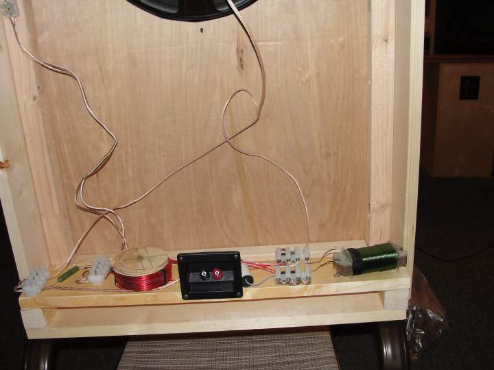

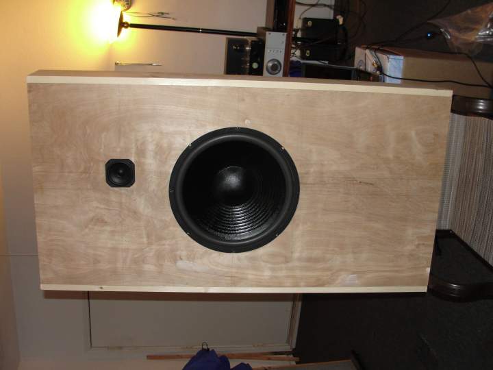

OK, trying to post a few pictures of the Ultra to help fill out the project.  The views are self explainatory.
panomaniac
Thanks for the photos.  Can you review the crossover for us?  It looks pretty simple.

OK, trying to post a few pictures of the Ultra to help fill out the project.  The views are self explanatory.
Any reason why the tweeter cannot be closer to the woofer?
JBspeakerman
The driver locations on the baffle are based on a combination of factors.  The tweeter is offset from the center line to help with imaging, diffraction smoothing and proper OB loading. The position on the baffle provides part of the low end roll off slope and frequency knee.  Also, I set it 38" off the floor to be on axis for a seated listener.  The woofer location is just off center vertically to help minimise rear standing waves, maximise OB loading (lowest possible F= for the baffle - wing combo) and high enough off the floor to minimise floor bounce.  One could move the woofer upward closer to the Vifa.  You would want the final woofer position to remain off center vertically, above center if it is moved closer to the Vifa.  There may be some modification required to the crossover if it is moved.  The crossover is optimized for the current driver vertical separations.  Hope this all helps.

The woofer location is just off center vertically to help minimise rear standing waves, ... and high enough off the floor to minimise floor bounce.  One could move the woofer upward closer to the Vifa.
Funny. Is moving the woofer to the floor no longer the best way to minimise floor bounce? Was Allison wrong?
Rudolf
JBspeakerman
There are many aspects to any given design.  With the ultra's design, if the woofer were mounted as low on the baffle as possible,  the woofer - tweeter vertical separation would become a major issue.  Maintaining the Vifa at around 38" above the floor for me IS very important to the overall performance and power response of the system.  There is a limit to crossover correction capability relative to vertical separation of the two drivers. Somewhere around 15" of center to center separation seems to be the limit.   Otherwise major lobing issures begin to degrade the SQ. The accoustic crossover point is centered around 550 Hz, but the up woofer contribution reaches over 1 KHz, although it is down about 18 DB at that point.  The Vifa is contributing down to about 175 Hz.  (Down about 24 db at that point in overall power response).
Larger separation was not possible when maintaining a simple crossover topology - cost.  So the best trade off was to mount the woofer up higher.  With the woofer contributing well into the mid range, mounting it higher gets it's mid range output closer to the overall speaker axis. And with an OB woofer that is playing into the mid range, one has to deal with rear radiation issues including absorption than can occur with residential carpeted surfaces, front also.
Bottom line is the woofer is up where it is for a number of reasons.  Mr. Allison is just fine when operating in a traditional monpole environment..
I still don't like the tweeter separated so far from the woofer.
Mudjock
  • Posts: 83
    • Sehlin Sound Solutions
At a crossover frequency of 550 Hz, the driver spacing looks manageable.  While one might prefer closer, the impact of other factors would probably supercede that of the drivers being as close as possible.
JBspeakerman
You can move the woofer closer by around 2".  Any more you will over lap into the Vifa counter bore on the rear of the baffle.   You can barely see the dotted layout circle surounding the Vifa on the pic I posted a couple of days ago.  The rear counterbore is 7" diameter IIRC.  Not as much un unused baffle space as one would think!
