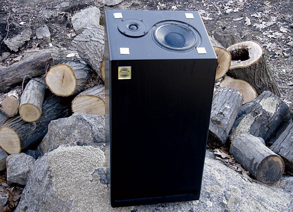

So reading through the older parts of the thread have me intrigued. The statements about the X-Omni being better than the X-LS Encore are also interesting as I'm considering building the Encores. How is the X-Omni different than the A/V-O? And am I correct in assuming the X-Omni or A/V-O would need as much breathing room as say the X-Statik?
The X-Omni uses the slightly larger M-165 woofer compared to the M-130 woofer on the A/V-O. And they use a different tweeter. But the design type is the same and both sound very good.
And any omni style speaker needs to be at least three feet from any wall.
