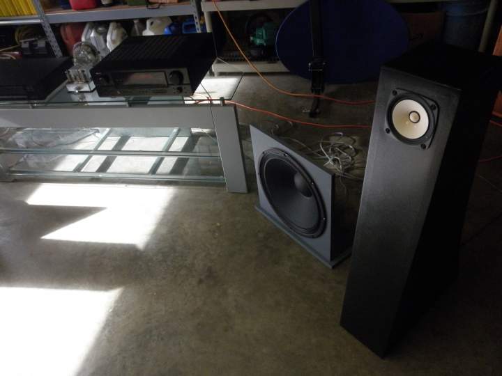

Here's my solution to increase Mk3 bass when you can't stick them in  corners. These are Alpha 15A FR bass speakers in a simple open baffles.

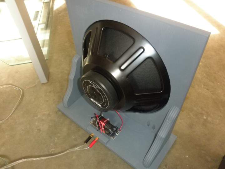

« Reply #27 on: 17 Dec 2011, 04:00 pm »
Mk3 bass augmentors

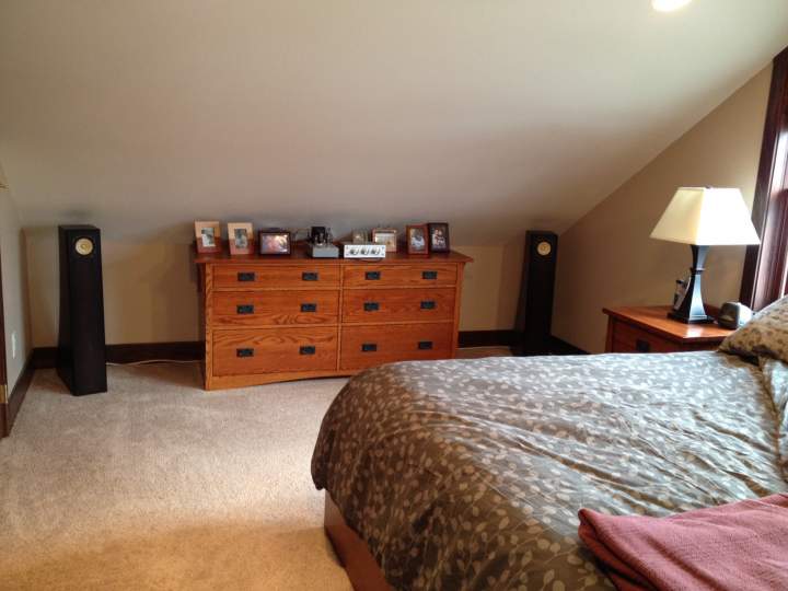

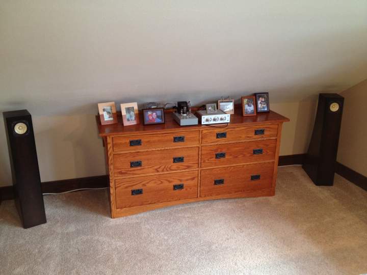

« Reply #28 on: 19 Dec 2011, 07:11 pm »
Moved them to corners, and has slanted ceiling too....super improved sound, much lower on the bottom end and the owner is extremely happy.  It is now a 3 watt bedroom system.  I am looking forward to trying the Wyred for Sound Udac next month with an Apple TV2...
