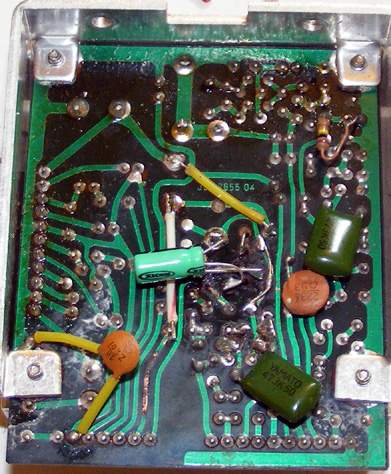

Repaired board:
Circuit board (Audio/VOX/Key up) control to a 1979 Kenwood TS-180S. I had to partially rebuild this board because someone with no soldering/repair skills attempted a repair. The result was torn traces and a manual keyup toggle on the side of the transceiver.  :?
There are components & wire bridges on this side due to factory revisions. The board as shown is now completely within factory specifications. You can still see an overheated trace from when the relay control transistor originally shorted out. The glaze was burned off, yet the trace survived and remained glued down.
This is a demonstration of a badly damaged board and how it should look after a good repair has been made. I have worked on worse (burned through boards) and revived them.
The moral is: Badly damaged boards can be repaired, BUT they will never be like new again physically. There is always a BIG scar.
