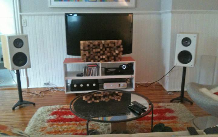

Have the monitors farther apart now. LP is at the apex of an equilateral triangle, again, relatively nearfield.

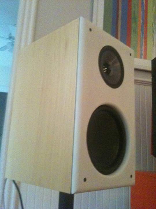

Soundfield Audio Monitor 1
It was a leap of faith, as so many things  have been since I started caring – really caring – about the sound that my home stereo system was making. That began when a friend of mine who ran a thrift store casually gave me a pair of B&W DM602 series 2s that she had come into possession of. She already had speakers, and knowing that I’m a musician and music lover, she told me to take them home with me, and contented myself with some cool speakers. After a couple of years, finding the sound (especially the low end) lacking, and remembering various friends along the way who had good sounding stereos and what a pleasure it was to listen to them, I made the decision that we must have all, at one time, made: To get great sound.
The leaps of faith have included ordering a Polk sub, which I could never get to sound right in my place, buying a preamp (pretty good), an amp (very good), and a disc player (so-so), all sight unseen, from various sources; eBay, Echo Hi-Fi, Amazon, and the like. The leap that yielded the most disappointing results was buying a pair of Definitive Technology BP8020 floor standing ‘super towers’. I had heard their bigger brothers the BP8080s at Best Buy some months before that, and had been impressed with the dynamic range and fullness of the sound. The secret, the enthusiastic sales guy said, was the active bass – a powered subwoofer in each speaker. Cool, I thought. That’s what I need. One subwoofer in my room never sounded good, maybe a stereo pair, coupled with a quality mid/hi driver array would bring the warm, live, purty sound the I craved into my living room. Being on a budget, the 8080s, at $2,400 wasn’t an option, so when I saw an open box special on the smaller 8020s for only about $650, I jumped on it and thought, well, these will be just like the bigger ones, only I can afford these!
Long story short, I could never get these towers to sound good. They produced an incomplete frequency response, resulting in a ‘hole’ right around 125 Hz, so while the sub bass was pretty good, the higher bass frequencies were just AWOL. Ugh. $650 leap of faith, and I didn’t clear the chasm of calamity.
So I was gun shy but determined when, after two months of sound I didn’t like, I started looking for a replacement set of speakers. I posted on AC about my quest, alluding to the fact that I thought the acoustics in my room were a problematic, and were there speakers that were more forgiving of room dynamics? Oh, and not much more than $1,200 please. The good people on AC were right there with myriad suggestions, tips on setting up my room better, and recommendations for speaker models that they thought might work.  It was a lot to process. However, one thing stood out; talk of a set of monitors that some ‘AJinFla’ had built that more than one commenter said I should consider. I read the thread where others had been asking about them, and in which those who had heard them were giving them high praise. People were saying that they couldn’t believe the sound they heard from them; so dynamic and full, and just from a set of medium sized monitors.
I started corresponding with AJ, asking questions and realizing that if these could deliver on the promise- stereo subs, pure mids and highs – that my current speakers had failed to, they would be worth the $1,000 that AJ was charging. So I took one more leap, and said build ‘em, white please, and send them my way. AJ did this with efficiency and a friendly, communicative disposition, patiently explaining aspects of the design and build as we went.
We shipped, perhaps foolishly, the speakers on the eve of Hurricane Irene, from Florida to Long Island. We were both a little unsure about how that would work out, but Fed Ex ground came through without even a day’s delay.
Excited, I carefully unboxed them and beheld AJ’s handiwork. What struck me first was the heft of them, the solidity, and the modern coolness of the maple cabinets with their white baffle, offsetting the black and gray drivers. After all, the color was my idea, so of course I think they’re cool looking. The weight is due mainly to the .75” MDF cabinet, but also the very substantial magnets in both the 8” Elemental Design long throw subwoofer driver – 10 lbs each! – as well as the magnets in the 5.25” KEF Uni-Q coaxial mids/tweeters mounted above each enclosed sub. All that comes to about 35 lbs per speaker, a heft that certainly tests my cheapie speaker stands’ capacities. The cabinets, with its perfectly veneered edges, look as though they were carved from a single piece of wood. I don’t know how this is achieved, but it gives them a real air of quality. The back of each speaker is dominated by its 300 watt BASH plate amp, with the crossover, various connections, power section, and gain control. Because of the design, none of these elements need to be futzed with except for the power/standby switches, input binding posts, and the gain.
I set them up, switched them on, and then called AJ for some setup tips. While on the phone with him, Diana Krall’s Live in Paris came on, the first music that I heard with the new monitors. As I finished the phone call, I knew that  it needed to be turned up to make sure I was hearing what I thought I was hearing.  Sure enough, the sound filling the room was so smooth, so musical, I immediately had a big grin and thought, this is it… they’re legit.
From the online commentary, I had been prepared for a big sound, and it is big. It’s a very ‘room filling’ experience, much more so than I had expected, but it doesn’t need to be at high volume to get there. I think this must be due to the wide dynamic range that the Soundfield Audio Monitor 1s possess.
Paired with my Acurus DIA100, a passive preamped 100 watt solid state amp, the SAM1s seem to really shine. The Acurus is a very neutral amp, and drive them with precision and clarity, allowing the speakers to do their thing. I say it must be a good pairing because the resulting sound is, among other things, very warm and inviting. This was the big surprise to me. I had no idea how round, how natural music could sound out of a pair of monitors. The tight, staccato bassline and purring low notes in Me’shell Ndegeocello’s “Dead Nigga Blvd (pt. 1)” are so accurate, it really sounds like an electric bass well played, not ‘the bass from a speaker’. The highs are very detailed, spread out across the soundstage, but never, ever harsh or shrill. Again, it doesn’t come across as the treble from a speaker, it sounds more like the treble in the music.
AJ refers to Dr. Floyd Toole’s work on speaker/room interaction and psycho-acoustics when explaining why he chose the coaxial driver. The idea is that a great deal of what we hear are actually off axis reflections, so that the off axis response of a driver design in a room is critical to a smooth, unsmeared, and dynamic listening experience. He says he found that the KEF Uni-Q to be the ideal product to achieve this balance between on axis and off axis sound. When I first heard the way well recorded acoustic guitars sound through the SAM1s, courtesy of Foo Fighters and Porcupine Tree, I immediately got what he was talking about. Shimmering, natural, and precise, again, never brash. This was the room working for me, not against me. Halelluyah!
One of the true tests in the rock genre is how cymbals sound when there’s a lot of other stuff going on. The Foo Fighters “Echoes, Silence, Patience, and Grace” was a good proving ground. While not perfect, the SAM1s did an admirable job detailing and reproducing cymbals in the middle of hard rock bedlam.
Even though I’m in a quasi nearfield setup (6.5 feet back from the speakers), my impression of the soundstage width and depth is favorable. The stage extends all the way to the rear wall, and wider than the speakers themselves. Instruments are distinct with good separation, and the monitors fairly recede as the focal points of the music.
In the end, though, it’s two words that most readily come to mind when I listen to the SAM1s: Smooth and coherent. The combination of these two assets really invites the listener into the music, rather than having the music be projected at one’s head like a weapon, as I’ve experienced with my last speakers. The smoothness gives music a contour that is very pleasing to the ear. But it’s the coherence that I think might be the best part of the Soundfield Audio monitors. Music sounds more put together, makes more sense, and communicates feeling easily. I experienced the drum solo in Dave Brubeck’s “Take Five” in a whole new way. The phrasing, the fun that the drummer is having with the groove was a revelation. Beyond the mechanics of stereo active bass and concentric mid/high drivers is the sense of wholeness to the presentation. But I know that these technical features make this quality possible, so props to them :D.
These speakers are thoroughly quiet. With my ear right up against them and the Acurus amp set to 1:00, total silence. And that’s with three amps in the equation.
They are also fairly revealing (also because of the very favorable aforementioned signal to noise ratio?). My 128 kbps AAC files that I purchased way back when from iTunes (doh!) sound, well, like 128 kbps files. Unfortunately, I have some of my favorite music in this format. CDs will be ordered directly (these speakers beg for redbook quality, but my 320 kbps files sound very good as well).
It’s only day two with these speakers. But, like falling in love, when you know, you know. The Soundfield Audio Monitor 1 is a special speaker in my opinion, in that it delivers a complete, coherent, and exciting sound for a reasonable amount of cheddar. These babies are recommended for anyone who has had trouble making their rooms sound good, anyone who wants powerful, musical bass without the uncertainty of placing subs, and anyone who likes their music served up with capable grace and panache. All it took was some research, luck, a little cash and…  one more leap of faith.

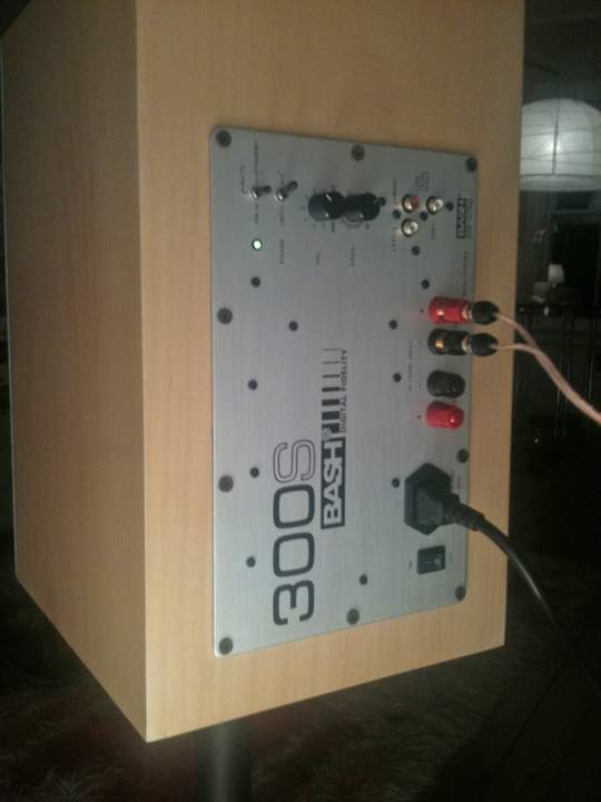

Any thoughts on longer length powercords (10ft -15ft ) for the plate amps?
I see that there are extensions made with IEC connectors.
http://www.parts-express.com/pe/showdetl.cfm?Partnumber=110-180
And I see IEC adapters for extension cords like the Walmart White cord:
http://www.amazon.com/Hosa-PWA421-Female-Prong-Adapter/dp/B000AJM27A
Any thoughts... the 6 ft will be too short for me.

Hi Jeff,
The stock cord is 8', not 6. But if that's still too short, then yes, just about any IEC type cord will work. Like this nice 14ga one from Monoprice: http://www.monoprice.com/products/product.asp?c_id=102&cp_id=10228&cs_id=1022801&p_id=5293&seq=1&format=2
I'm a bit apprehensive about the Walmart adapter, because that extension might put more stress on the plate amp socket. I'm pretty sure they make white/grey IEC cords too.
cheers,
these look great, and i would love to hear them.  mebbe when the tour speakers are ready, the speakers will have the feature to connect passive subs to the built-in amps - that's something that would be a requirement for me.
meanwhile, move that table out of the way, and let me know how much better everything sounds.   :wink:  and, while that diffuser looks great, completely covering the tv w/an absorbent blanket will also help...
