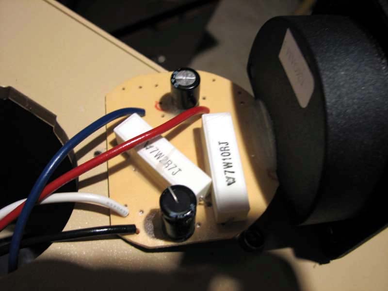

Oh yeah, those Algonquins are the speakers that I was thinking of.
Here is a picture of the crossover.
With that metal cone woofer running full range and allowed to ring in all its glory, I would image them to be very hard to listen to for more than a few seconds.
The Algonquins are said to be able to withstand a fall into the pool.
Something tells me that this ported speaker wouldn't fair too well in a pool. That raw MDF on the inside would turn to card board pretty quickly. The woofer wouldn't fair too well soaked either. In fact, having seen the insides of these speakers I would imagine them to do to well in high humidity either.

I resin enclosure? That would help. Having seen the insides though, I wouldn't call them water proof.
As per a review of them, the reviewer said:
The crossover is mounted to the terminal cup and has no protective casing over the electronics. Although Axiom claims these speakers are fully weatherproof and waterproof, I beg to differ on their definition of what that means. In Florida where it rains pretty much daily during the summertime, I'd hate to see what happens if someone mounts these speakers in an open area and gets hit with a fierce storm of blowing rain-filled wind. My definition of waterproof is a speaker that can be submerged in a pool for a week and still play after you take it out. There are very few speakers on the market that can do this, so I categorize all others such as these as weather "resistant". My advice here is to place them under a covered lanai.
And having measured and tested several of the Axiom speakers, and knowing the issues with them, I really couldn't recommend their consideration to anyone.
