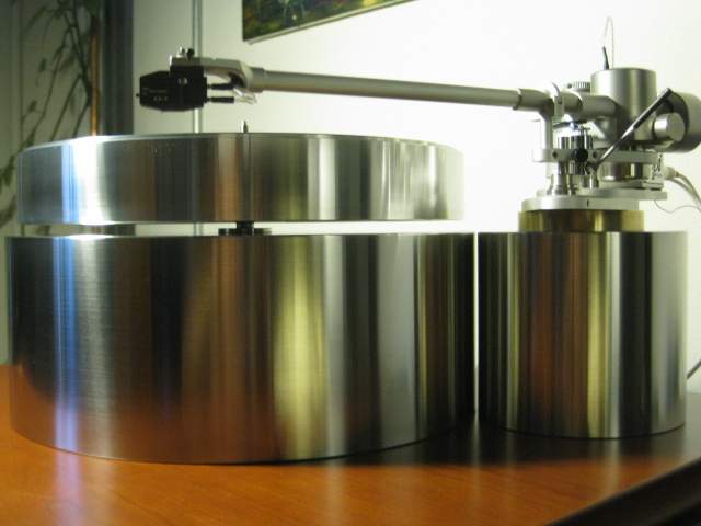

Just finished building this base and arm pillar for Tuans Vpi. I was inspired by the davinci I saw at true sound.
Base is a 12" piece of steel tubing with a 2.5" thick piece of steel plate shrunk into it. Base is around 110/120 lbs. Arm pillar is 6" ss round solid.
Fired it up with a cheapo motor just to hear it and so far so good. Final tweaking and evaluating will occur back at Tuans house.

Thanks, I enjoyed making it. I had been knocking the idea around with Tuan of making his next deck and when I saw the davinci I was inspired by the simplicity and elegance. I am also happy that there is a lot of room for upgrading with this design. Nothing gets thrown out. New subplate on the arm pillar for new arm. Base will also fit a teres style bearing and platter with minimal modification.

Machinist by trade yes.
Many years of building prototypes for others, now I get to make these for my friends. Used to just build motorcycles for fun, now I am enjoying this analog business.
The slug was cut out of the plate with a standard old gas axe.

I figured since the base was static I would not be generating any interference.

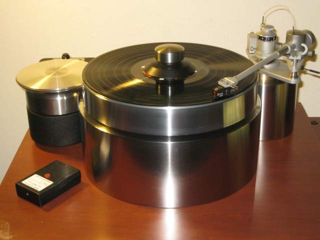

here'w what it currently looks like!
VPI Rim Drive, VPI Classic Aluminum Platter, VPI 10.5 tonearm and tonearm base, Dynavector XX1 with SS retip, line contact.  Also have a Shelter 901 with a 10.5 stainless steel arm

Direct coupled mass is the key to great table designs. I learned that when I made ARcom, stuffing the innards with lots of plasticlay. The mass simply stops internal/external born vibrations. Great machining.
What did we finish the external/internal surfaces with? Plain steel will corrode after time. It does appear to be plated?

It does appear plated. The base is just polished and waxed. There is about a dozen coats of wax on it. It is not a permanent finish, but there is a certain vibrance to polished metal that plating diminishes, imho. Also getting good plating in California is near impossible.

Well, we estimate the plinth being about 130lbs, the arm column about another 30lbs as well as the motor/rim drive another 25lbs...so, approximately 200lbs?  or so...
Dave, it sounds good initially, more tweaking but first I have to find a time where my wife and 3 month old is out of the house (loft) to really know!
