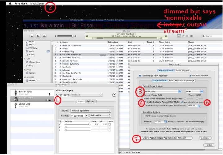

If your DAC supports it you absolutely owe it to yourself to run and do....integer support (which bypasses floating point conversion and reduces the signal path complexity)!  It is PM's greatest strength, sounds FANTASTIC...oh, and disables volume.  :)   First set to hog mode, restart and then go back in and set the integer checkmark (again, assuming your DAC supports it).
http://www.computeraudiophile.com/content/Updated-integer-mode-capable-device-list

ENABLE EXCLUSIVE ACCESS (“HOG” MODE)
This option reserves the audio device for Pure Music’s exclusive use while Pure Music is running.
To use this feature, the audio device selected in Audio MIDI Setup should be set to a different device
than the one used by Pure Music, to allow iTunes to fully access an audio device if necessary. Accordingly,
by default, Hog Mode cannot be used for the audio device selected in Audio MIDI Setup.
Disabling Strict Device Validation will bypass this check, but doing so is at your own risk (may cause
an unexpected quit in iTunes or Pure Music).
If using the Built-In audio with a toslink cable, install the Channel D Playthrough Audio Driver (see
below) and select it in AMS as a default device. (Another alternative is to purchase an inexpensive
pair of “USB Computer Speakers” and select them in AMS to use for system output sounds.)
NATIVE INTEGER DEVICE SUPPORT
After setting Hog mode and relaunching, this option will be available if the audio device supports
nonmixable native integer streams. This will bypass all signal processing in Pure Music (including the
volume control). Selecting Integer will cause the warning to appear:
Also, Disable DSP Options mode will be activated (see Disable DSP Options below) and the menus
that configure signal processing options and metering will be hidden. Signal level metering will be disabled.
page 23 here http://www.channld.com/Pure%20Music%20User%20Guide.pdf
Pretty vague though.
ted_b
  • Posts: 6345
Re: Pure Music Volume Control Settings
« Reply #18 on: 19 Aug 2011, 01:27 am »
For integer support, you need to do these steps:
before u start..... make sure you have PM version 1.8a or greater installed on Snow leopard (Lion has no integer support currently)
1) first deselect your DAC in Audio Midi, meaning select "internal output" instead (but amke sure your DAC is shown, just not selected)
2)  make sure memory playback is chosen in PM (top menu, music server)
3)  then go into PM's audio setup (not preferences) and select your DAC from the pull down list
4)  then click on hog mode checkbox
5)  then hit "click to apply changes"
6) then when PM comes back on, click "native integer format support"
Your banner should read "nonmixable integer output stream"
My quickly put together screen shot and mark up, sorry...  :)
