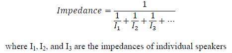

if your drivers are 8 ohms, running three in parallel will give you a 2.67 load that your amp will see.  many good amps can handle this load, and some will output considerably more wattage into such a load.  but check your amp to be sure...

That will give you the highest sensitivity, if your amp can handle the lowest impedance dip. The problem is Doug is right about 2.67 ohms if that is the lowest impedance dip. But most 8 ohm drivers will have dips much lower than that. If a single driver has a dip down to 4 ohms, then your amp will see a 1 point something ohm load. (1.33?? I don't know doug's cool formula.  :icon_lol: )  With full bandwidth drivers the lowest impedance is usually around 100-300Hz, and there is a lot of music energy there. So just be careful that the amp doesn't overheat. If your drivers are 16 ohm nominal, then you should be OK with any decent SS amp.

rich is right - if the actual impedance dips below 8 ohms, the paralleling of them will also dip correspondingly.  the formula is easy; yust insert the lowest actual impedance as the walue:

Here are a couple of links to the math required to calculate series and series parallel circuits.
http://www.electronics2000.co.uk/calc/series-parallel-resistor-calculator.php
http://learnabout-electronics.org/resistors_20.php
Basically you can't add 8ohms and 16ohms in parallel and come out with a resistance higher than 8ohms. The 16ohms in parallel will always drag down the resistance of another resistor of a lesser value to a combined value below that of the smaller resistor. Take two resistors of unequal value connected in parallel and your ohm meter and measure the resulting combination.
Scotty

« Reply #17 on: 21 Aug 2011, 08:50 pm »
Scotty
oops, my bad.  big time brain fart here; your formulas are the same as what i posted. :duh: :oops:
but, lowering impedance by running drivers in parallel will not give you more db per watt; it will simply give your amp more headroom by allowing it to output more watts.  whether or not your speaker's power handling ability can handle the added output is another issue...
the added spl of running additional drivers is solely due to increase of the spl of each driver.  doubling the drivers gives a theoretical addition of 3db at any given wattage.  if one driver is 88db/1w, then two is 91, four is 94, eight is 97, etc...  headroom is also increased, as you can run eight 30w drivers up to 240w.  but, you are increasing the headroom of the system; each driver still max's out at 30w.
doug s.
