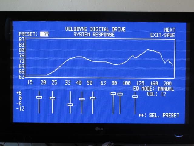

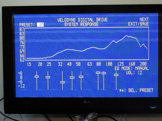

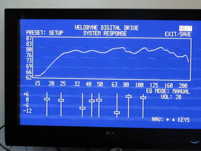

Here is a visual generated with the Velodyne SMS-1
Dynaudio 25s Full range/ no sub
25s cutoff at 80hrz crossover/ no sub
25s augmented with Velodyne sub, crossover at 80hrz
Also I've limited the output of the sub to 20hrz although it can go lower.
As you can see the 25s are very respectable in terms of bass output for an 8" driver but I find a sub fully completes the audio spectrum. I’m in the camp that prefers to use a crossover on the mains to increase dynamics and head room by letting the sub do the dirty work and the use of the Velodyne SMS-1 really helps to iron out any peaks and valleys from unwanted room nodes.
The benefits of reducing the bass output of the mains I believe outweigh the negative effect of having more electronics in the chain, the results being less congestion in the midrange producing a better defined sound field especially if you like to listen loud or at realistic levels.
If your listening preference is low to moderate volumes you may find running the mains full range beneficial.

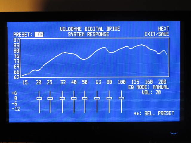

The output of the BP25P goes to the Velodyne SMS-1 crossover and yes everything above 80hz goes to 4BSST to power the 25s although there is a gradual slope so the 25s are still putting out bass as shown here, everything below to the sub.
Mains crossed over at 80hz no sub.
Room correction is only applied to the sub by the Velodyne SMS-1 with an 180% inversion to stop bass cancellation by putting the sub's bass in phase with the bass that the mains do still produce.

Always keep in mind crossovers are not a brick wall and both mains and sub will continue to produce frequencies above and below the crossover point, which has always been problematic in getting a seamless transition between the two. Although I've been fairly successful over the last 25 years or so, the introduction of SMS-1 or any device to correct room nodes and the hand off between the mains and sub has been extremely beneficial and has made correctly integrating a sub much easier.
