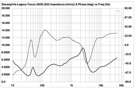

That's why. Although this is the Focus 20/20 measurement; ever since the mid 1990's when Focus came into inception, it has always had a nice impedance dip into the 3 ohm range (and tough phase angle) right in the presence range of most music, i.e. lower midrange to midrange, so using an amp that clearly has some current capability into 4 ohms is well advised.
Here is the full link to the measurements section that Stereophile has published online on the Focus 20/20.
Hope this helps  :wink:. As for which AVA amp, I'll let the usual AVA experts answer here.

Wow!  That is interesting information.  The ohmage really dips down!  Does that mean I need to have an amplifier that is stable to 1 ohm or two ohms?

The SE dips to 2.3ohms at 30Hz and 2.5 at 75Hz, otherwise always above 4ohms. The 2020 went to 1.9 with 60 degree phase. The new speakers are easier load and more accurate freq response in the bass.
With speakers that can play loud like Legacys, amp headroom is important so that the midrange melody doesn't distort when you crank up the heavy bass. Don't short change yourself if you think you will play them loudly, or very loudly like they are designed to play.
