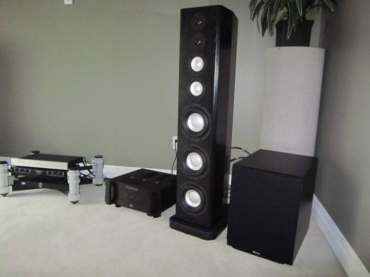

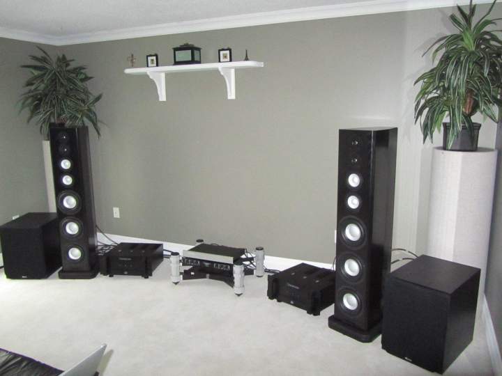

Trying Model T in room 2 - no subs running.

« Reply #362 on: 7 May 2012, 10:16 pm »
Yes the 6B's are perfect - probably a little overkill on the tweets.
I wanted to try them in a smaller room (12/18 - long wall).  The nice thing about acoustic suspension speakers (sealed box - no ports) is they are really well controlled so it does not overload even a small room with low end which is usually the case with big speakers in small rooms.
I am getting abour 25Hz at the low end so with the M80's I liked having the subs engaged but with the Model T - not needed!!!
Having fun :thumb:
james

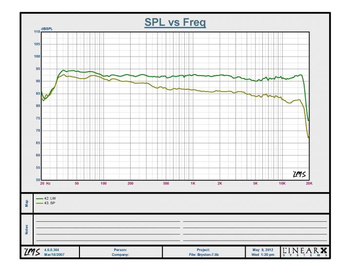

Hi Folks,
Here is the latest anechoic camber 'Listening Window' and 'Power Response' measurements of the Model T.
james
SoundGame
Re: Bryston Loudspeakers
« Reply #365 on: 9 May 2012, 09:29 pm »
Hi James,
If I'm reading correctly, it looks liKe 30 Hz to 17 KHz +/- 3db is the frequency response.  In room, you would probably loose 2Kz or so off the top, due to absorbtion, so how does that impact their airiness, if it does, at all?

« Reply #366 on: 9 May 2012, 09:48 pm »
Hi James,
Hi,
Sounds very airy and spacious - the total power response is far more important that the direct on axis. That's why we feel the power response is more representative of overall frequency balance in a room.
james

« Reply #367 on: 11 May 2012, 02:20 am »
Here's the M80 v3 test results:
This seems to highlight what I saw in the Model T response - the M80 does not have the rapid roll-off above 17kHz - any reason why the Model T does?  Though this may be a mut point given that you say the perceived extension in the treble is all there.
On the bass response, the M80 is definitely lumpier as you get below 60 Hz and drops off faster, which would make it likely less anchored in the bass frequencies then the Model T.  Though I'm sure with the active crossover in the Model T, transients are also that much more fast and impactful.

« Reply #368 on: 11 May 2012, 10:40 am »
Hi SoundGame,
Yes the nice thing about the DSP crossover is you can really fine tune the frequency response to a much greater degree than with passive networks and so far this result sounds the most balanced.
james
