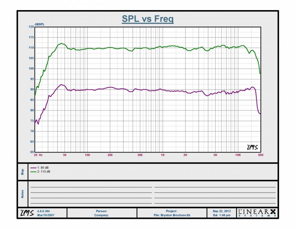

It’s an important distinction and worth discussing.
The ability to play loud is part of the compression equation but generally refers to how loud or the maximum sound pressure level a speaker can achieve before it starts to distort the waveform (Model T is 118 dB).  You can see this in the measurements in some reviews.  So there is definitely a correlation between dynamic compression and how loud a speaker can play… but I think when people refer to ‘lack of Dynamic Compression’ they are referring to how well the speaker responds to high level transient material as well as the ability to maintain the dynamic contrasts in the music. If it compresses the transient dynamics things can start to sound squashed and take on a hard and glassy character. I always remember my first speakers that where Klipschhorns and man when a dynamic transient came along it was REAL WORLD!
Some reviewers test the speakers at 90dB sound pressure level and look at the linearity of the frequency response – if it looks good in some cases they will test the same speaker again at 95dB. For instance Sound Stage Magazine puts this comment in their speaker test info :
PLEASE NOTE: Our standard is to provide the THD+N measurement at 90dB with a measuring distance of 2 meters (within the anechoic chamber). Since this speaker produced low distortion levels under those conditions, we have added a second measurement performed at 95dB to give an indication of performance under higher-output conditions.
In the Model T it was one of the main goals I tried to achieve – I wanted a speaker that could produce real world transients without distortion given current dynamic driver technology.  This meant developing our own drivers of course but in the end you can produce a speaker that performs exactly as you want.  Here are the anechoic measurements of the Model T at 90dB and then at 110dB! – Notice how little change there is in the frequency response even at very high sound pressure levels.
This means that there is very little compression or distortion going on when those huge dynamics hit and it truly can provide real world dynamics as well as the ability to play at very low levels as well as high levels without changing the dynamic contrasts in the music.

Excellent explanation James and yes, that is what I was shooting for.  A speaker that can handle transients at ANY loudness level, especially at low to moderate levels.  It is not often that I listen real loud, but that is what I  find common in most explanations of dynamics.
What I am after (and it appears you too with this design) is the difference between high and low sounds and accurate transient response without compression - at any volume level - correct?  That is what makes music sound real.
I think so as well - the music has a real world feel about it - we have all heard really loud dynamics in our everyday lives and we just know instictively they are not reproduced sounds.
