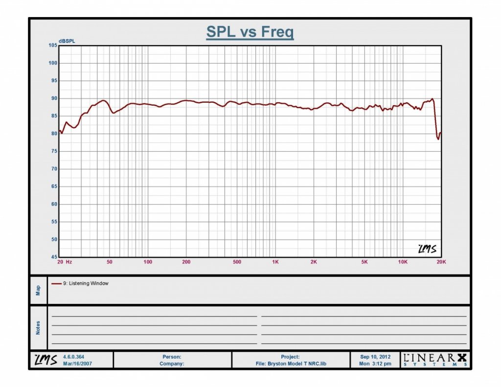

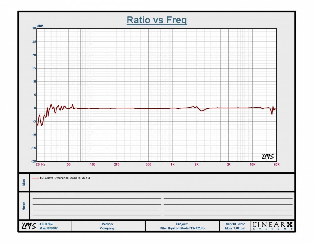

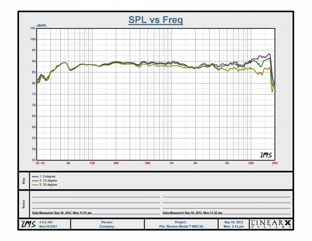

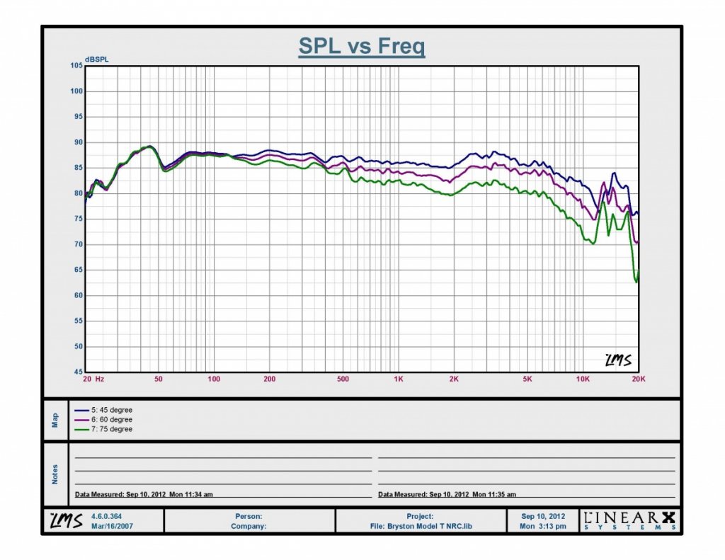

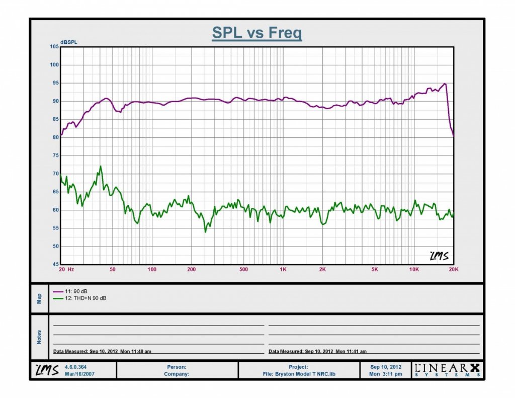

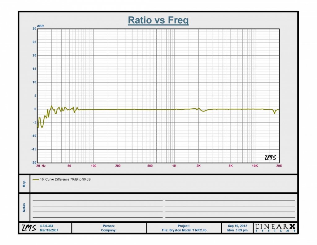

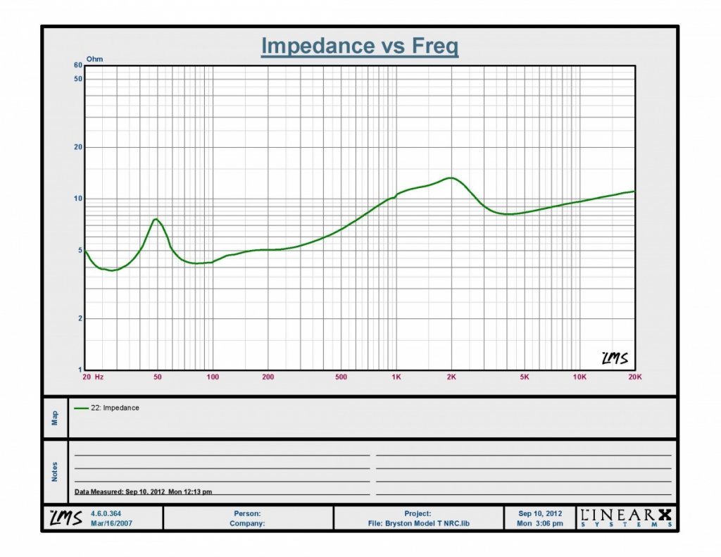

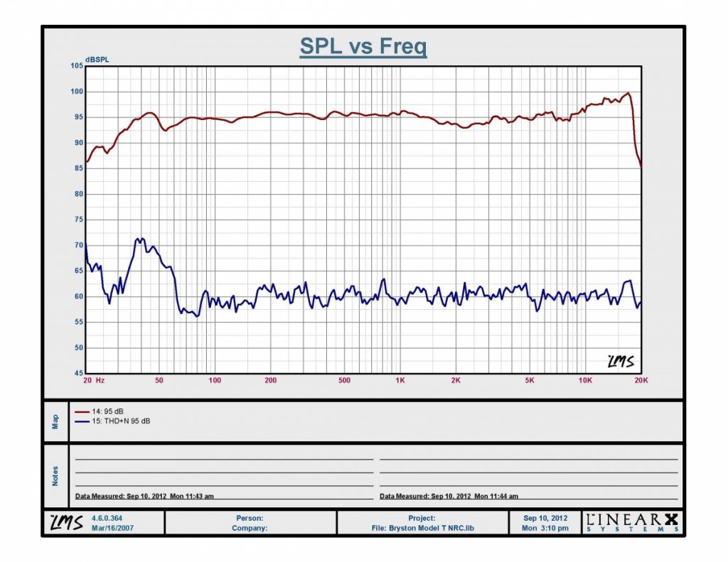

Hi Folks,
Some Anechoic measurements on the Model T Speaker:
0/15/30 Degrees
45/60/70 Degrees
Difference 70dB to 90dB
Difference 70dB to 95dB
Impedance
Listening Window
THD + Noise 90dB
THD + Noise 95dB
james

What is "Ratio vs Freq"?

« Reply #615 on: 11 Sep 2012, 03:40 pm »
Hi James, I admit I don't know about testing and meaurements, especially the finer points, but I do at least look at graphs, like the ones you posted on the Model T, when they are made, such as in Stereophile reviews.
These seem to show a degree and level of flatness that I don't recall having seen before.
Is my memory worse than I thought? Am I misunderstanding something?
Dave

Hi Dave,
No the measurements on the Model T are exceptional by industry standards and I am very happy with the final product  :thumb:
james

Hi John,
Yes graphs can be a little confusing I agree.
Basically the graph shows the 'on axis' frequency response at 70dB then an overlay of the same on axis measurement at 90dB and finally 95dB (quite loud).  Many speakers will deviate from flat frequency response as well as increasing distortion as you increase the power.  As you can see the Model T tracks very well.
One of my main goals with the Model T was I wanted them to be able to accept huge amounts of power (no dynamic compression)  without deviating from their flat frequency response or increasing in distortion. This is a good test to show how a speaker performs under those conditions.
james

Hi James,
Could you comment on the graphs below 50hz, they all seem to deviate from "flatness". Does this indicate the need for a dedicated Sub, or, on the contrary, would you say these graphs show/prove how flat Model T is, in comparison to other Speakers.
Marius
Good question  :thumb:
Most Anechoic chambers will not allow for an accurate measurement below about 50-80Hz (otherwise their size becomes unrealistic) so what is done in our case is the bass response measurement is made on a pole outside the factory 100 feet in the air and then that measurement is used and over-layed with the anechoic response to get an accurate response below 50Hz.
So you can ignore the response below 80 on the graphs.  I will try to get you a much more technical answer from Ian as well.
james
