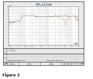

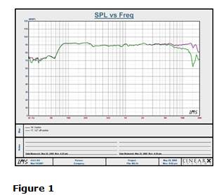

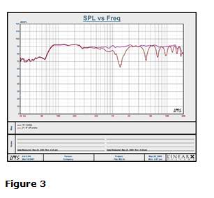

Simply stated, comb filtering is two signals arriving at the same location at different times. Because of the differences in the arrival times, the sound waves will have additions when they perfectly overlap and reinforce each other, and also have cancellations or nulls where they cancel each other out (the latter is called destructive interference). This occurs in virtually all speaker systems whose musical ranges overlap, where both drivers are reproducing the same sounds, as in stereo or surround sound, and because of multiple drivers with different physical locations used to cover the same frequency range.
To illustrate how a single measurement microphone “hears” or identifies comb filtering, we set up an interesting experiment in the anechoic chamber. Two quality bookshelf speakers were placed in the chamber 6 feet apart. The calibrated B & K microphone was placed 6.5 feet away and directly in the center in the sweet spot between the two speakers. A standard frequency sweep from 20 Hz to 20 kHz was played back over the two speakers and we recorded the test sweep with the measurement microphone. The purple curve in Figure 1 shows the frequency response with the microphone exactly centered in the sweet spot between the two loudspeakers.
Then we moved the measuring microphone ½-inch to the side, off center from the sweet spot, and recorded another frequency-response curve. The green curve in Figure 1 shows the first comb cancellation effect at 15 kHz.
Then we moved the microphone 1 inch off center and ran another curve. In Figure 2, the green curve shows the next comb filter cancellation at 5.5 kHz. In Figure 3, the measurement microphone was moved 8 inches off center from the sweet spot. The dark greenish curve shows the pronounced comb-filtering cancellations beginning just below 1.5 kHz and extending all the way up to 18 kHz. The dips in response resemble the downward teeth of a comb, hence the name “comb filtering”.
The cancellations (dips) are what the single measurement microphone “hears” and measures using a full-frequency test sweep when the signals from the two M2 speakers don’t perfectly overlap. This seems like an acoustic effect that may be potentially nasty in nature and should be avoided. These are pronounced cancellations, yet when we play music or speech over a pair of speakers, we don’t hear these comb filtering effects. Why is that?
