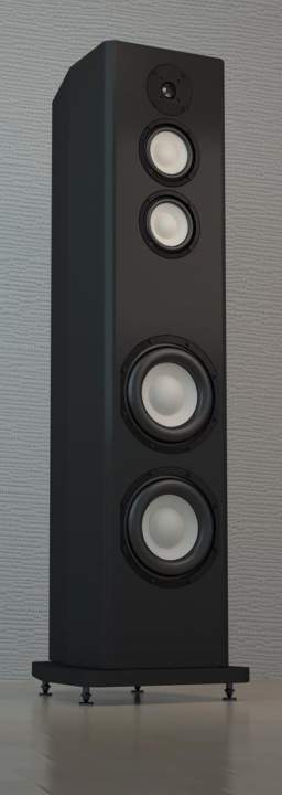

JT-1 Active speaker project so far.
james

Re: Bryston Loudspeakers
« Reply #41 on: 11 Aug 2011, 05:50 pm »
Looks good! And coming from you, it most likely sounds good as well...
Any chance of giving us a peek into the blueprints?

Hi James,
Looks like you are geting closer to see the result and I really want to hear it from you that which crossover you will like more,the digital or Bryston.
Have you decided which amp you will use? I would say a pair 7Bs and two 4Bs would be perfect.
Good luck. :thumb:

« Reply #45 on: 12 Aug 2011, 02:32 am »
will be interesting to see the results!
looking at the prototype design, the drivers in play and the fact that they are a "Canuck" speaker I have an idea as to who the co-builder is but I'll be quiet in case I'm wrong.... :wink:
mr_bill
« Reply #46 on: 12 Aug 2011, 02:37 am »
Striking similarity to PSB  :)
« Reply #47 on: 12 Aug 2011, 02:57 am »
not PSB
james

Hi James,
Good luck. :thumb:
Hi prelude
I was thinking maybe 2 recommended systems: one would be Bryston JT-1 LITE and use 3 channels of a 9B per speaker and Bryston JT-1 MAX using as you suggest a 7B and 4B per speaker :thumb:
The other option I am thinking of is maybe a dedicated custom 3 channel amp with each channel custom to each separate driver ( woofer mid tweet) with the appropriate power per driver?
James

Hi,
Yes the crossover and speakers would be sold as a package. The amplifiers could then be used in any number of configurations.  The custom amp would be just a plug and play approach.
The whole idea with this speaker is the crossover, drivers, box, amps etc are all part of a 'system' designed to work together.  It has been very interesting listening to different crossover points and slopes and adjusting phase etc on the go in the DSP crossover. I think though if we make the crossover do whatever is required then the customer could use his own amps if he wanted as long as all the amps have the same gain.
james

 The drivers remind me of Canton's Vento models. They are well made ,in house German units.The enclosure is similar as well. Are they bottom ported James? :peek:
James Tanner
  • Posts: 20997
  • The Demo is Everything!
    • http://www.bryston.com
« Reply #58 on: 12 Aug 2011, 10:42 pm »
SEALED = no ports :nono:
james
