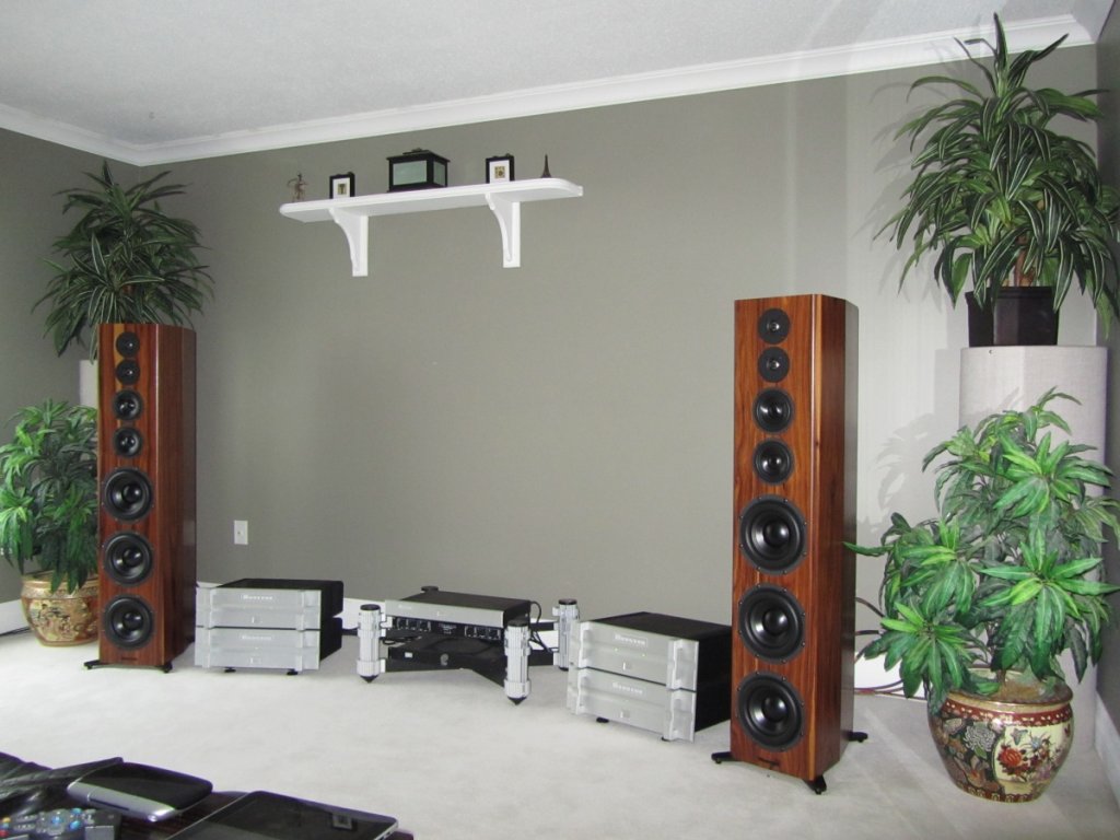

Ok the smallest room I have used the Model T in is 13 x 11 x 8 and I used the long wall.  Here is a pic of that setup:
This is a Active system.
It worked well but I ended up using some tube traps in the corners behind the speakers.
I assume you like a higher soundstage based on your speaker stand remarks so the Model T will certainly give you that effect as they act like a line source.  The dispersion from the Model T's is very good so once you get back about 6 feet all the drivers integrate very well so even though the tweeters are high they will sound very balanced.
My only concern is bass build up in the room so in that regard the Middle T's will sound very similar to the Mini T but with a little more bass articulation and less distortion through the bass range due to the double woofer.
