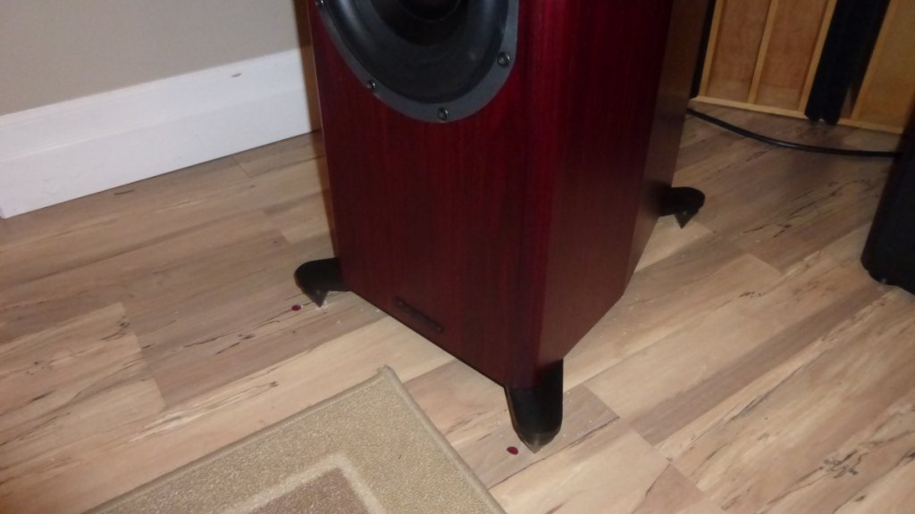

Hi
Here is a shot of the outriggers I mentioned.
scirica
Re: Bryston Loudspeakers
« Reply #2081 on: 18 May 2015, 02:47 pm »
Outriggers ordered too. Thanks James!

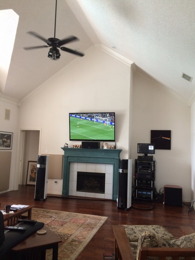

Mag
« Reply #2087 on: 18 May 2015, 08:05 pm »
IMO you want to have the Model T's spaced as wide as possible. In my room spaced 10' apart the speaker acts as a boundary. I don't even hear the speakers but the soundstage imaging between the speakers. 8)
95Dyna
  • Posts: 1180
« Reply #2088 on: 18 May 2015, 08:07 pm »
Nice room.  Are those 1038 BE's?  If they are and you are replacing them with Model T's that's a big hats off to the Brystons.  I've heard the 1038's and was very impressed with them except for the very low end.
James, how much does the high ceiling account for the soundstage performance?  My room is currently 16'x21'x10' high and I'll be moving to a similar sized room that is longer but the ceiling is lower 16'x27'x8' high.
Thanks.
scirica
« Reply #2089 on: 18 May 2015, 08:11 pm »
Thanks.
Yes, those are 1038be's but they are only on loan as an in-house demo. I do love the mids and highs, but there is something lacking in overall sound stage and as you mentioned the low end.  And the Model T is 1,000's less than the 1038be's.  What I'll actually be upgrading from is Focal Aria 948's.
James Tanner
  • Posts: 21001
  • The Demo is Everything!
    • http://www.bryston.com
« Reply #2090 on: 18 May 2015, 10:33 pm »
Thanks.
Yes the high ceiling just adds a sense of height to the stage but with our speakers first reflections from nearby surfaces are not a problem.

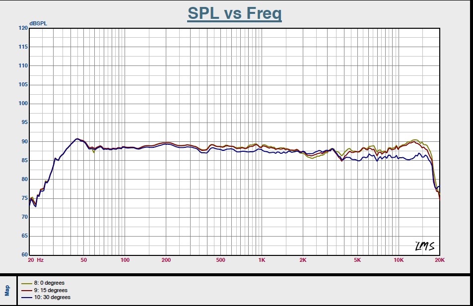

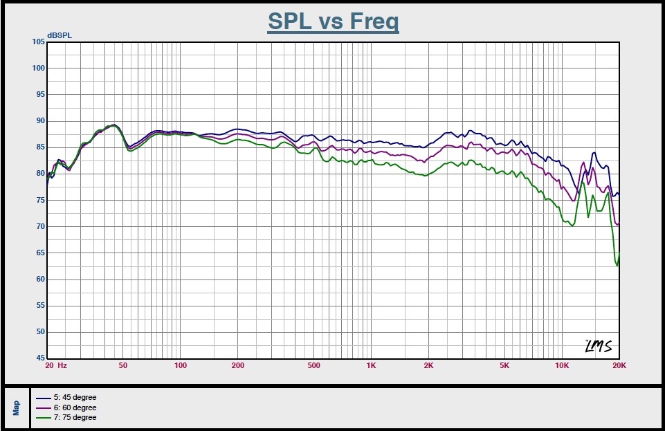

Hi AJ - put this together this morning for you - hope it helps.
You are NEVER listening in the NEARFIELD or the DIRECT SOUND from the speaker.
HI Folks
Many times I get asked why Bryston is not concerned when placing our speakers in normal domestic audio rooms as opposed to acoustically treated rooms.
The two most critical parts of any loudspeaker system choice is the listening ‘ROOM’ and the loudspeakers ‘POLAR’ response. Recognizing how the room imposes its boundaries (floor, ceiling, walls) on the speaker and how that speaker radiates its energy (polar response) into a specific room is critical to the understanding of the overall performance of any speaker and it is no different for the Bryston loudspeakers.
When you are listening to a loudspeaker in a room you are always listening to balance between the ‘Direct Sound’ and the ‘Reflected Sound’ from the boundaries of the room – this is called the ‘Power Response or Sound Power.’ It is that balance between direct and reflected energy which changes depending on the frequency radiation pattern (polar response) of the given speaker and the boundaries of the room the speaker is placed in.
The ‘direct sound’ is the sound radiating from the front of the loudspeaker and the ‘reflected sound’ is all the sound your ears perceive after the sound waves have interacted with all the different boundaries in the room. It is important given real world conditions that the on axis response and the off axis frequency response of a loudspeaker be as uniform as possible.
Recognize when you listen to a speaker in a room you are NEVER listening in the NEARFIELD or the DIRECT SOUND from the speaker.
This on and off axis characteristic is generally referred to as Polar response. The smoother and more uniform the on and off axis polar response of the speaker the better the tonal balance between the direct sound and the reflected sound will be. In other words, the reflected sound will have the same overall tonal balance and sonic characteristics as the direct sound if ‘on and off’ polar response is smooth and even. This approach also provides the optimum overall 3-dimensional soundstage presentation as well. The Bryston Model-T is a very wide dispersion design so the polar response is very flat on axis and very uniform all the way out to more than 75 degrees off axis in both directions from center to provide a very wide and even listening window.
So the boundaries of the room are used to enhance the listening experience by providing a sense of spaciousness and naturalness to the listening experience.  We all listen in real rooms and our brains are use to interpreting the overall direct and reflected energy in a specific manner.  I find rooms that treat the reflections by trying to absorb them just makes the listening experience very unnatural and almost anechoic.
Also remember that you cannot absorb all frequencies equally as the thickness of the absorption material affects the frequencies it can affect.  So a few inches of fiberglass or whatever absorptive material will only affect a specific range of frequencies – generally midranges and highs so it creates an energy imbalance in the room.
Many people will disagree with me but I have gone the route of serious absorption in many of my rooms and have always reverted back to less absorption is better and I much prefer Dispersion over Absorption. That’s my story and I am sticking to it !
James
