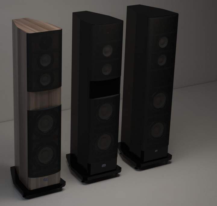

I like the split cover look but you should get more adventurous with color - not just black.

Some ideas?
The example on the right. Go with a metal grill, and magnetic attachment, similar to the Monitor Audio Platinum series. That sure would have helped the fellow with the Nautilus speakers.
Rick
SoundGame
Re: Bryston Loudspeakers
« Reply #143 on: 19 Aug 2011, 04:46 pm »
Some ideas?
Really like the more transparent grills - not sure I'm fond of the split grill, especially when the veneer is not dark.
Would magnetic mounting (invisible mounts) be in your plans - it gives a much cleaner appearance when grills are off?
If not an aluminum front baffle - how about a solid aluminum plinth with outrigger adjustable feet?

Yes magnetic grill mounts
james

Hi James:
I'm thinking that this design could be set apart from your partnering company's house look and Brystonized, as it were if you took a little different direction with the front baffle that would likely be also a potential functional improvement.
Have you considered going with a:
1/2 thick solid aluminum front baffle with Bryston styling cues?
The baffle could be made in...black or silver.  A number of the high-end speaker seem to be adopting aluminum structural designs to increase structural rigidity and reduce cabinet vibrations.  I'm thinking this could improve the structure but also clearly link to the Bryston line of products.
