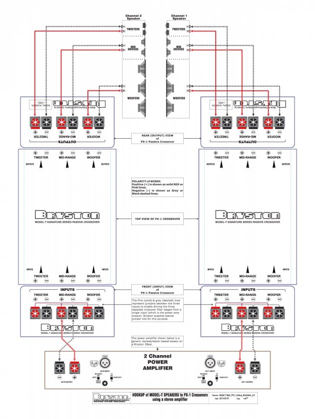

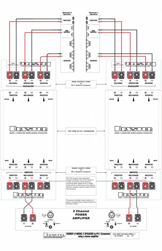

Hi Folks,
A number of people have asked me how the Signature Model T speaker external PASSIVE crossover hookup works.
Below is the hookup:

Hi James,
Thanks for this info. How would two 28b mono's hookup?
And, why would you have the external crossover have 6 inputs, while we only have two outputs on the amps? And you designed the crossover to internally connect the inputs high, mid and sub?

Hi marius,
What we do now is bridge the 3 sets of INPUTS ( with external links which can be removed) ) so the customer can use his current set of cables to connect to the input on the Signature crossover. Then we sell a cable kit for the Sig crossover output or the customer can use 3 sets of his own cable.
So with the 28B's - which I use - I just have the single set of cables from the 28B to the crossover input.  Sometimes at shows I will use the 2 sets of 28B outputs.

James, thank you!
Still, im a bit in limbo. Could you post a diagram of connections using 2 mono amps?

Hi Marius,
It would hook up exactly like the Stereo amp in the diagram except two separate amplifier chassis of course.

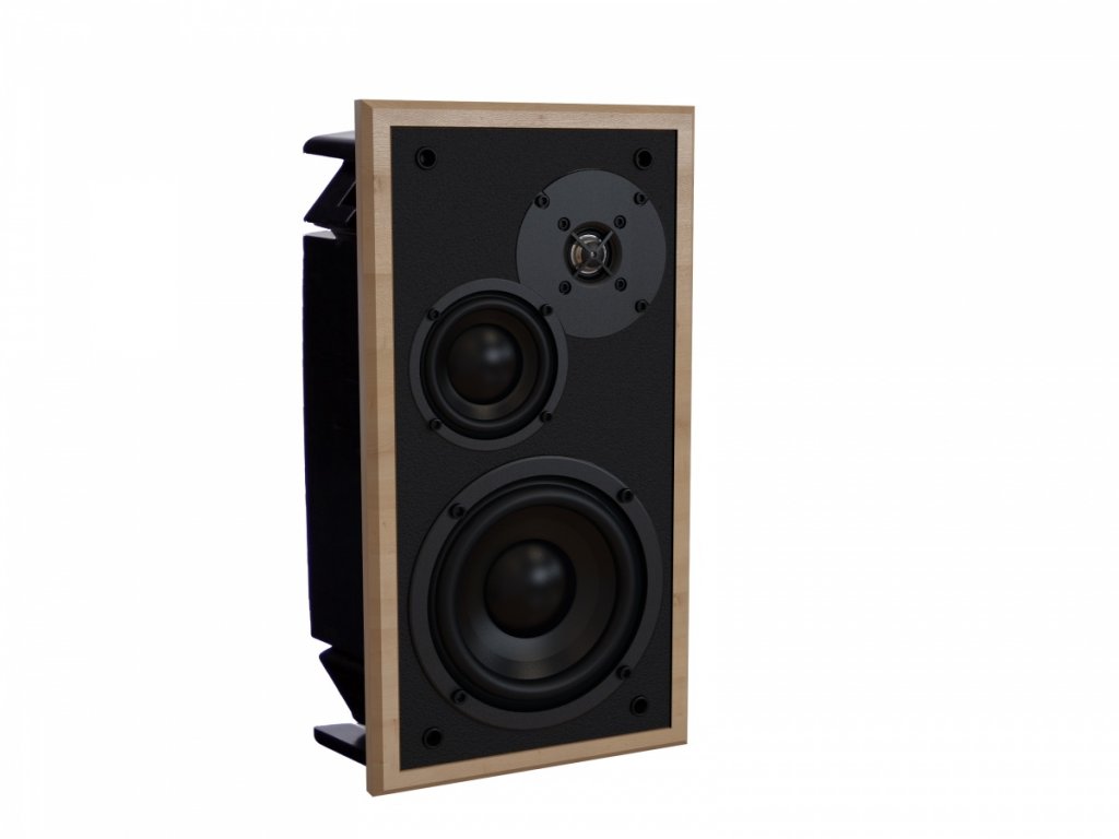

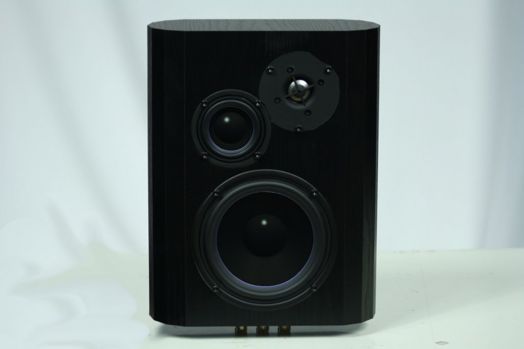

Hi Rich - yes we have an INWALL and an ONWALL available.
