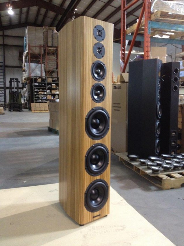

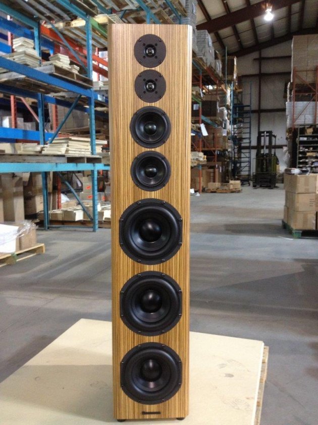

Hi Folks,
Factory shot of the Bryston Model T speaker in a special Zebra Wood finish.
James

Those look very nice James. Will you soon be publishing a list of available wood finish options.
Rick

Hi Rick,
The standard stocking colours are Boston Cherry, Natural Cherry and Black Ask and now Walnut.  Rosewood has been popular but I thought something a bit more stricking might be fun to show.
We can really do most finishes as a Special Order so no official list as such.
james
