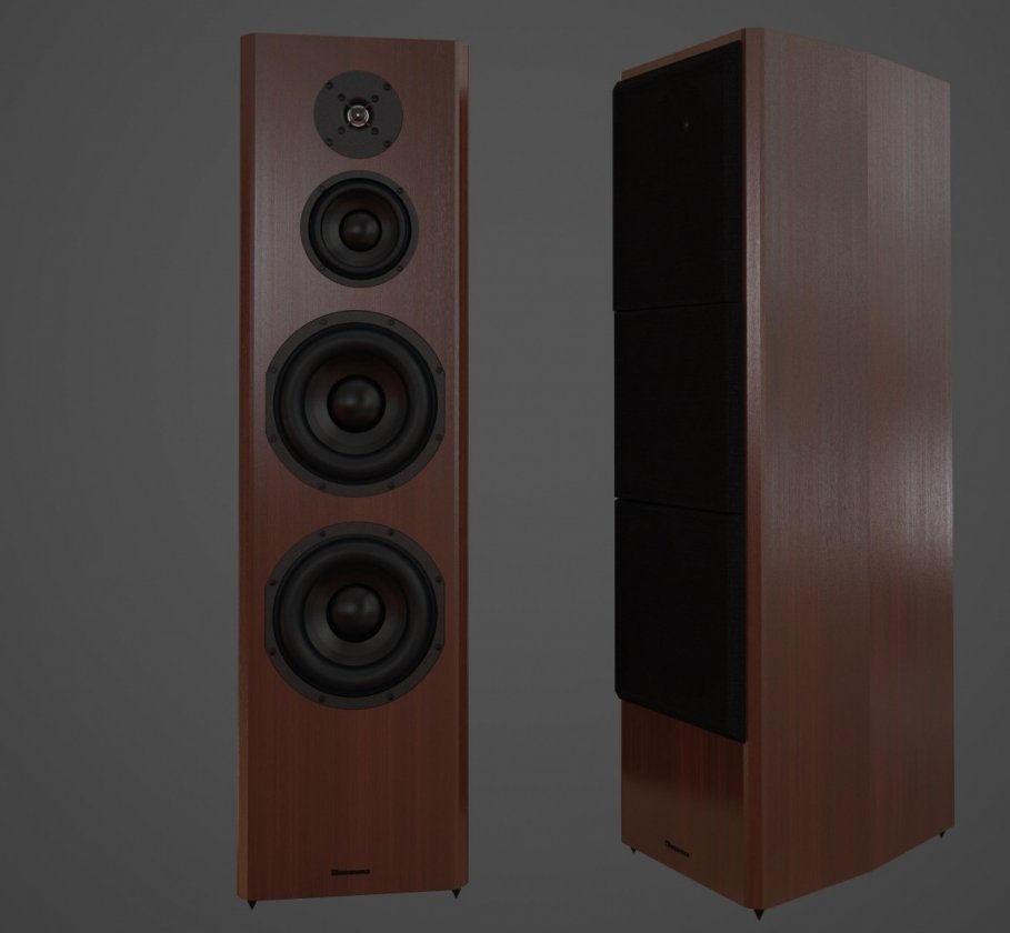

Hi Folks,
A couple of shots of the new Bryston Middle T speakers.
james

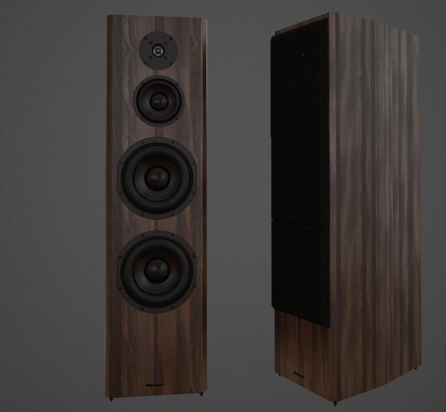

Hi James,
Any ideas as to the price roughly? Is the second picture Walnut w/ real vaneer
Mark
James Tanner
  • Posts: 21076
  • The Demo is Everything!
    • http://www.bryston.com
Re: Bryston Loudspeakers
« Reply #1090 on: 14 Mar 2013, 09:51 pm »
Hi James,
Mark
Hi mark,
Its a custom walnut wood vaneer preordered.
$4600 the pair list in vinyl.
james

Bryston  Middle T
Frequency Response – 33 Hz – 22 kHz (+/- 3 dB)
Impedance – 4 ohms
Sensitivity – 88 dB 1 watt 1 meter (anechoic)
Max SPL – 112 dB @ 1 meter (anechoic)
Rec. Power – 10 – 250 watts RMS
Tweeter – 1”
Mid – 5.25”
Woofer – 8” (x2)
Crossover – 160 Hz & 2.3 kHz
Dimensions mm - H-1000 x W-267 x D-410
Dimensions inches - H-39.5 x W-10.5 x D-16.5
Weight kg – 37 (each) lbs – 81(each)

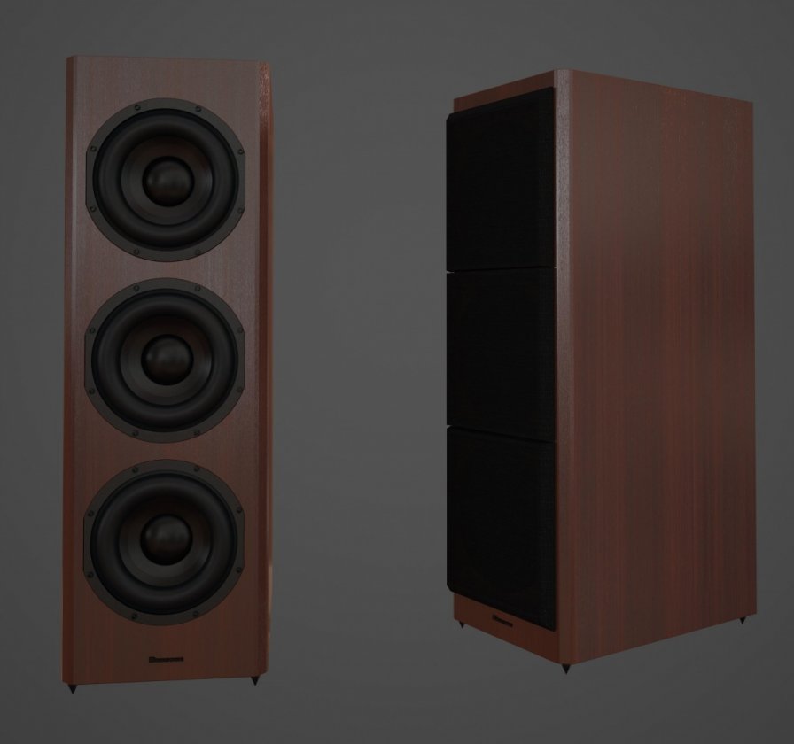

Bryston  Model T SUB Subwoofer
Freq. Response 18Hz to 150Hz (+/-3dB)
Maximum SPL 108 dB SPL @ 1 meter
Power 10 watts to 500 watts RMS
Woofer 8.0” (triple)
Crossover 40 - 150Hz
Dimensions mm - H-985 x W-267 x D-424
Dimensions inches - H-38.75 x W-10.5 x D-16.75
Weight kg – 48 (each) lbs – 105 (each)

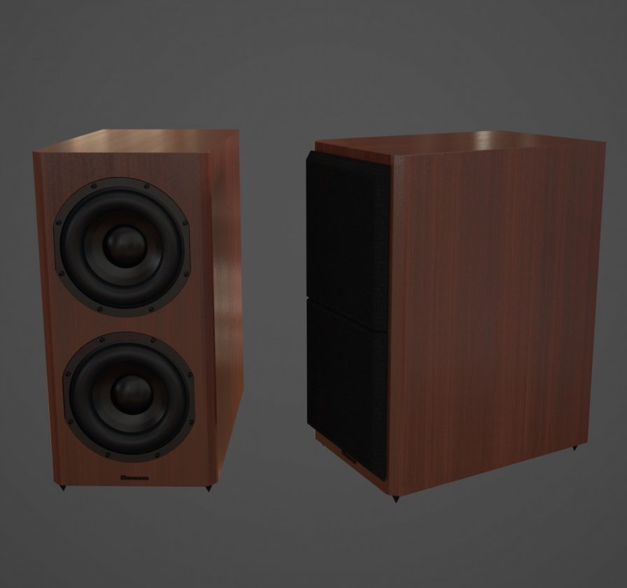

A shot of the Bryston Subs - small sub is under development now.
james

 that small one is beautiful ,how can a square box be wonderful to look at?But it is.
