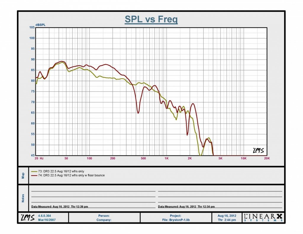

James,I'm curious for the model T sub  as to the 8" drivers even though there are three of em.
Was there any thought say using 10, or 12's.Course if the T sub surpasses some well known 15's I think I'm in.
I'm old school where I think and still do a bigger driver will move more air but maybe harder to control.
I don't care how big the sub is or the drivers it's the bass quality,lowend,mid bass punch ect.that count.
Have to audition 1-2 of these just to see and compare to my _ _ _ _as I have not heard anything like it yet.
Have to light a fire under Roberts butt to get a few in at AA.
Hi Don
There is method in my madness for choosing three 8 inch woofers over a single 15 other than style of course.  There is always a "floor bounce" dip when you place a subwoofer in a room.  The floor bounce creates a dip in response due to the distance the woofer driver is from the floor and the distance your ears are from the woofer. It can be a very large dip and the advantage of 3 stacked woofers is that each driver is a different distance from the floor so the dip is greatly reduced due to the averaging.
Below is a graph of the model T Sub showing the in room response and you will notice it is very smooth with no large dips up to around 300 Hz.

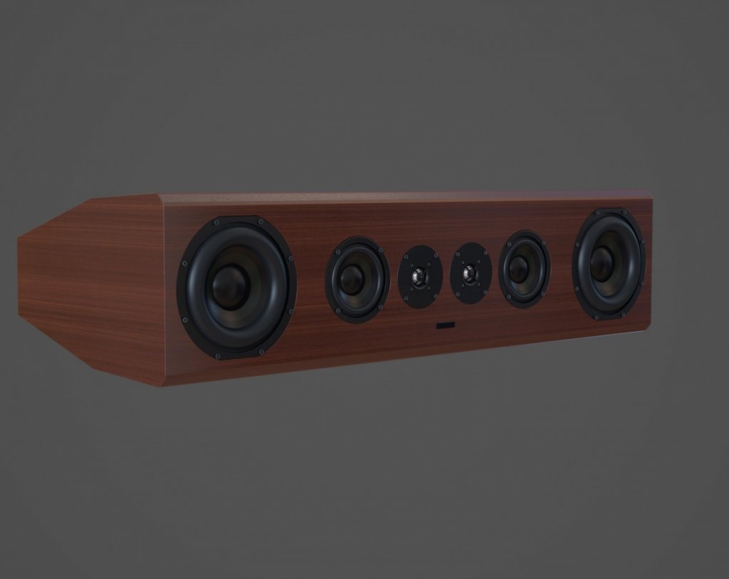

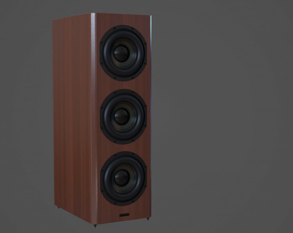

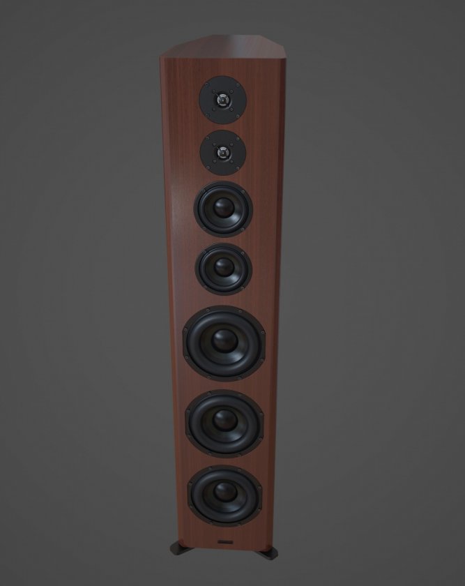

Some recent shots of the new center, sub and Model T

Hi James,
Forgive me if this has been asked before, but the sub looks like the bottom half of the full Model T. If this is true, do I really need the Sub then, if playing the Model T?

Fine looking family you have there James. :thumb:

Hi Marius,
You would not need a Sub with the Model T's - they are good down to 25 Hz.  The External Sub would go a little lower (17 Hz) but would be more suited to a Surround .1 channel or to augment the mini t's.   The Model T Sub is actually a little larger than the bottom of the Model T because we needed the larger internal volume.
