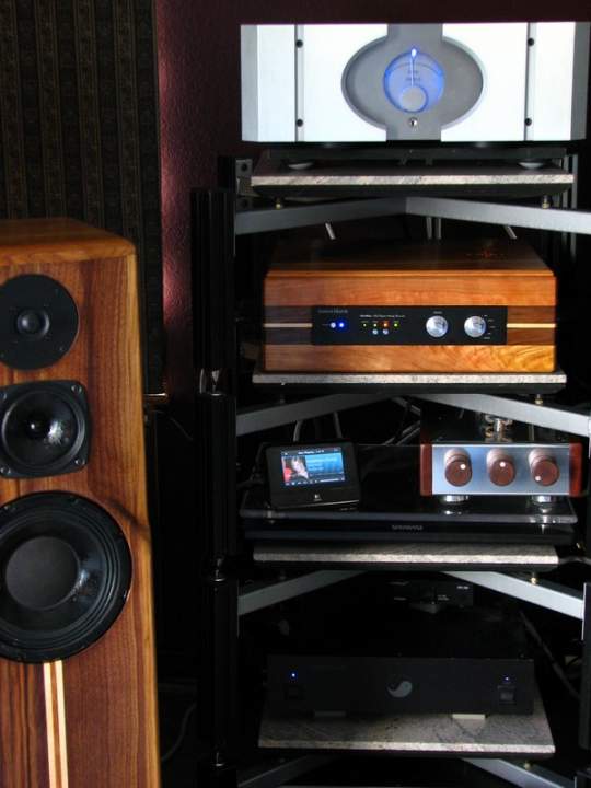

Here is a shot of the DAC in my rack
brj has gone out of town for a couple of weeks. While he is gone he has lent me his Pass Labs XA-30.5 amp. It has all the power that the Daedalus Athenas need. The pre-amp is a Hagerman Clarinet I built some time ago.
The sound with the Hyper modded DAC is fabulous. A great deal of space between all the notes. The recording venue is more obvious in good recordings. It truly brings to life the difference between redbook and 24/96 recordings.

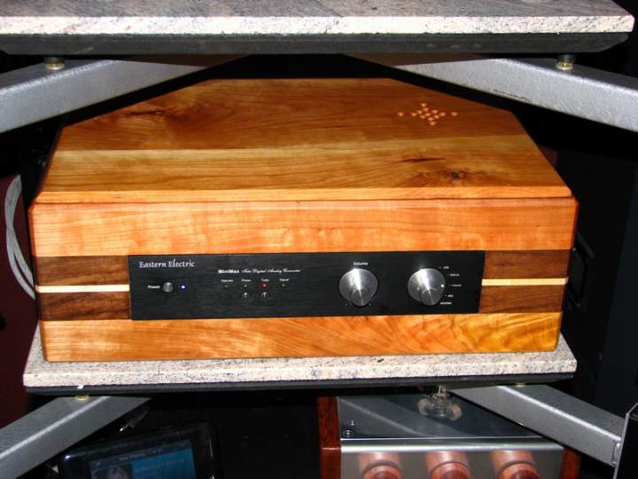

Here is a bit closer shot of the case.

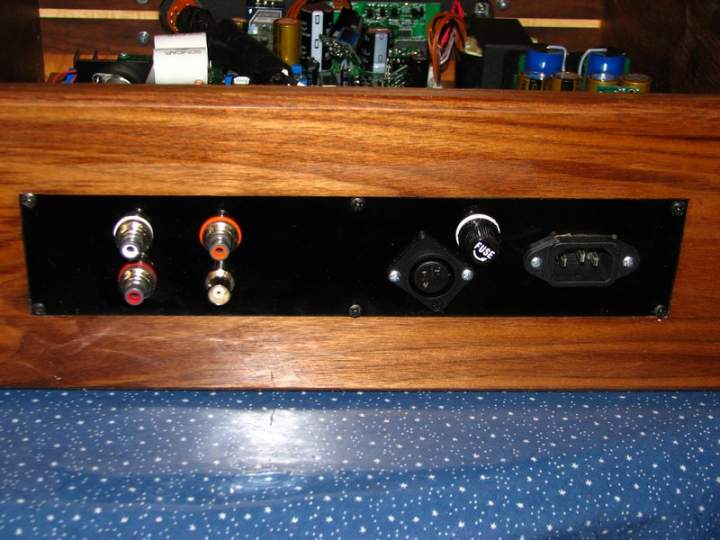

This is the back panel. Analog outputs and coax input are WBT NextGen Silver. BNC is Canare 75 ohm and XLR is Neutrik silver. AC inlet, fuse holder and fuse are all ACME Audio silver plated and cryo-treated.

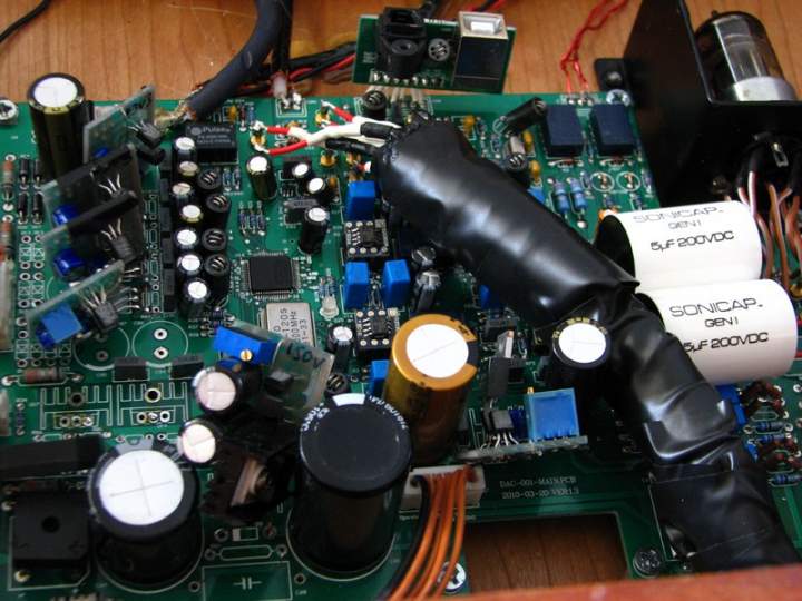

Here is what the EE DAC board looks like after a few Hynes regulators are added, caps changed, new op-amps and a few things done to the tube circuit.

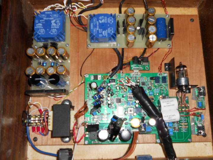

Here is a fuzzy shot of the whole shebang. The additional board at the back of the case has the transformer, pre-regulator circuit and Bybee Music Rail that feeds the four Hynes regulators used to send power the the DAC chip. The board on the left side has another transformer just for feeding the op-amps. Two Hynes regulators feed a positive and negative Bybee Music Rail
The other transformer is the stock unit to provide the high voltage to the tube, through a Hynes regulator, the filament voltage through the last Hynes regulator and 5 volts to operate the relays.
