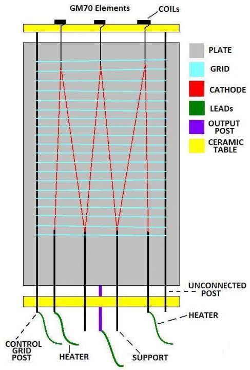

GM70?
http://www.shinjo.info/frank/sheets/018/g/GM70.pdf
http://www.jacmusic.com/nos/GM70/index.htm
Only thing I would mention is concerning the 20 volt filament. If run DC as the author suggests, the grid to cathode/filament bias will vary by 20 volts. Long term, this will cause uneven cathode "wear". I would place a switch in the filament circuit so once in a while, reverse the filament voltage, to more evenly "wear" the cathode. Just a thought.
Cheers Gustavo
Cheers Gustavo
Great tip Steve, thankyou again, Iam always surprised how many details can exist in a seemingly simple SET amp.
JacMusic site is promissing a GM70 Sakuma SET for years, but so far nothing...
What you mention refers to all big Triodes?? or just to the GM70 which have a longer cathode than the USA big triodes??
The 211,845,805 triodes have a filament wire like this ^^ in M shape and the GM70 filament is longer ^^^.
More details in the image below:

Hi Gustavo,
Well the 20 volts is high for directly heated triodes. Low Mu triodes, not so much of a problem, but high Mu triodes, yes more of a problem.
Cheers.

Thanks Steve, okay so far with the GM70, as it is low mu=6 to 8.
Thanks alot,
