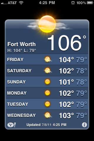

A friend of mine has a 9BSST with about the same clearance (no front door and open in the back) and drives a pair of Thiel 2.4s, a Thiel SCS3 center and has a couple of Vienna Acoustic Waltzes in the rears.  About the same distance from the speakers too,  The 2.4s are probably a couple of dB more sensitive.  Never had a problem listening to movies or music with it that way.  He has a townhouse and the system is in the basement level in the back of the house (the level at which you walk in).  I have seen an amp channel shut down a few times when he is upstairs in the kitchen on the next level and driving them very loud (2-channel listening).  So I'd guess it depends on your listening habits and how difficult a 4 ohm load you have.

I keep my system and myself in air conditioned space.  I think I need a vacation!!
