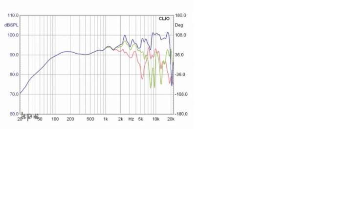

Oh man, all that tile, glass and unfiltered 1808s sounds like treble city.  I'm curious if you have any capability to measure your in-room response.
This is TB's own measurement.  My own were just as funky...
All that detail you guys are hearing is the same as turning the mid and treble knobs up on a receiver.  Not really the same as retrieving what is actually present in the recording.  To each his own and I know many people love these things, but wow, they are not linear at all.  Even crossed over and EQ'd, I could not make them work as a wide range mid for my tastes.

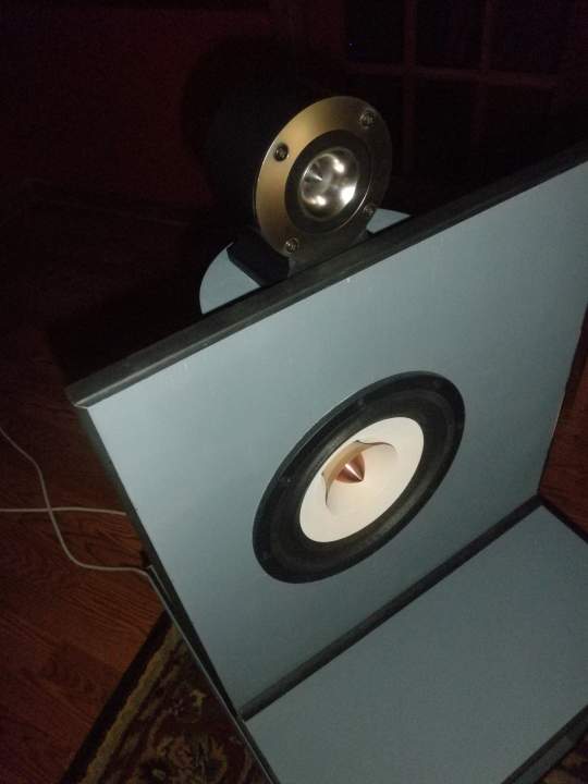

These Radio Shack super tweeters ( said to be made by Fostex ) add a nice shimmer to brushed hi-hats.

You have your tweeters on backwards.
Adding a tweeter like that will cause some major disruption to the on axis response. Depending on listening height, you will get some 6db peaks and 15db dips all over the place.
Face your tweeter to the rear of the room and you can get the same air and spacial ques highlighted without the huge disruption to the on axis response.
Made by Foster (who own Fostex). Be sure to rip the XO out of the pods and replace it with something better and more appropriate,

I tried them facing backwards but the cymbals go "tink" instead of "ting". But who knows it might grow on me.  :lol:
Not much of a XO just a couple of caps to replace.
Ones i have had all had a 2nd order filter with a dinky ceramic core choke.
