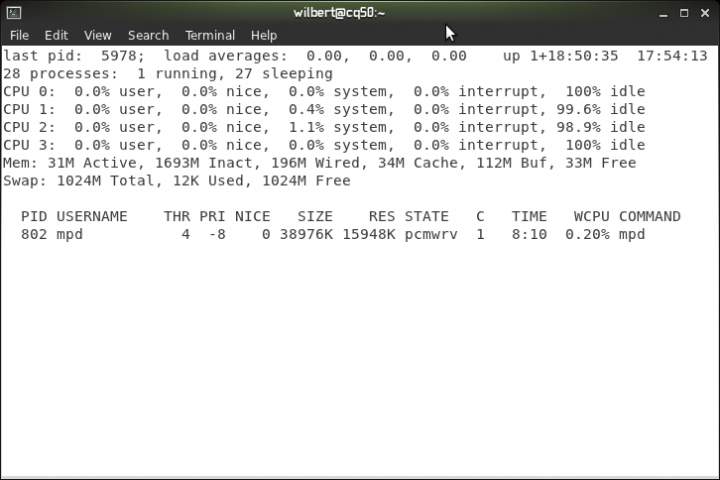

I launched #top -P, which then shows workload for 4 CPU's.
While listening to streaming radio, none of the CPU's is less than 98% idle.The workload is 1-2%.

I recall making that same mistake, because I experimented with OSS4 on linux.
FreeBSD-8.2 supports my HRT Music Streamer II out of the box, I notice that I need to reboot in order to get all the sound cards available (after editing /boot/loader.conf)
FreeBSD is a production beast, I had to refresh my memory and now I manage the system different compared to 10 years ago.
I do notice that the system is more responsive than linux and I really like the concept of system administration with /etc/rc.conf and userland in /usr/local.
Anyway, I also like the sound!
