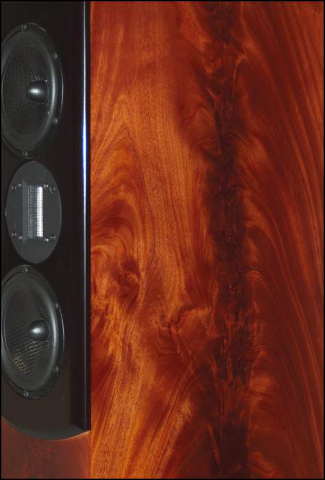

Ron wanted a pair of SongTower-like speakers but really wanted to "roll his own," so to speak.  He chose some nice Seas woofers and a Fountek ribbon tweeter.  He then developed a transmission line cabinet for the woofers and we built a test cabinet.  Once that was complete, Dennis worked his magic to bring all the elements together.
The cabinets are essentially the same as the SongTower cabinets but 2 1/2" deeper.
Ron selected some veneer and had it sent to us.  We took it from there.  Here are the results...
I have no idea why photos always look better on my computer than here on audiocircle.  The photos certainly do not do justice to this pair.  At any rate, here's a close-up...
Happy listening Ron!
- Jim

Jim how do they sound with the Fountek tweeter????. I'm looking at a similar build....very nice, very, very nice.....
...and what was the thoughts behind setting the tweeter slightly to one side and not centered in the baffle between the woofers.

The Fountek tweeter sounds much like the AC G2 and LCY 110.  It is a very nice tweeter.
As for the tweeter position, it is for diffraction control.  Centering the tweeter would certainly be easier since the same template can be used for both speakers.  But it is not ideal.
Keeping the analysis simple, if you center the tweeter, the distance to each side of the cabinet is the same and sound at a specific wavelength will hit both sides at the same time, creating diffraction artifacts in the process (think of turbulence at the edge of a wing).  You still get diffraction artifacts if you move the tweeter off center, but those artifacts occur at two different frequencies rather than one and the effect is cut in half.  So you get two smaller sets of artifacts rather than a single larger one. The result is response that is a little smoother.
Would you be able to modify the inside of the cabinet, perhaps adding thickness to one side near the tweeter, to achieve the same effect and keep the tweeter centered?
If I am understanding the question correctly, the answer is no.  Diffraction artifacts result any time sound hits the edge of the cabinet.  Sound always tries to travel in every direction.  Very short wavelengths (very high frequencies) can't because the sound hits the front of the baffle and is reflected toward the listening position.  That is why there is minimal high treble behind the speaker.  Longer wavelengths pass right by the cabinet edges and can travel around to the rear of the speaker.  But sound at a certain wavelength that is equal to the distance from the tweeter to the cabinet edge, will hit that edge and turbulence results.  This is a diffraction artifact and you can usually see it in frequency response measurements.  By moving the tweeter off center, you essentially create two different center to edge distances.  So there will now be diffraction artifacts at two different frequencies.  But sine they no longer reinforce one another, the amplitude of each is 1/2 of what they would have been if they were both at the same frequency.
So adding material to one side of the inside of the cabinet will have no impact since the distance from the center of the tweeter to the cabinet edge will not change.
I hope that made sense.
All that said, there is some debate as to how audible all of this is.  There are those who feel it makes little practical difference.  But in most cases, we tend to offset tweeters.  While it may not make a huge difference, it certainly can't hurt and it does help to some degree.
