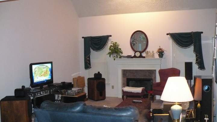

Man, that wall behind the speakers is awful - need some serious treatment there.  That alone will make a massive improvement.  Take care of that first, and only worry about the side wall after that, if you still think something is needed.  GIK has some cool "art panels" that would fit nicely on that huge wall.

If depth is what you want the front wall (behind the speakers) should be hard and clear. You have a lot of clutter there at same height of tweeters which is confusing the depth illusion. You also need to move the speakers farther out into the room, away front the front wall. Then you need to address the quality of your amplification.   Looks like the speakers are aimed directly at you, so you can try experimenting with the toe angle, either more outward or even more inward, although I think more outward will open up the stage width.
To address the thin tone, consider trying a speaker placement formula, such as Master Set, which you can search for info here on AC. Master set provides the most dense tone and flat freq response I have ever heard, but in my room it does lessen the illusion of depth. You might find the tonal balance is more important than depth. I go back and forth. The nice thing about Master set is that it allows the speakers to be placed relatively close to the front wall.
I would raise the 801s 6-8" to get the bass driver away from the floor for clearer bass and higher tweeter.
I would not buy any new electronics until you get the speakers dialed in right. I would treat the front corners to eliminate phase distortion from the tri corners. The quality of amplification has a big effect on imaging and depth illusion but it is minor compared to speaker placement and reflections from the tweeter.

I ready appreciate this help, all the help I get is from people trying to sell me something, I'm attaching the present set up as promised

Clap your hands in the room, loudly.  Does your room ring?  If so, then you will need some absorption.  I think the best place is on the wall behind the speakers, 2nd most important is the side walls beside the speakers, and lastly the corners/seams of the room.  In my experience, hard surfaces near your speakers will do more do mess up the imaging than anything.

Yes, I've done that no real ring. I have some moving blankets to try. On the right speaker I'll tack it up from the drapes to the wall and on the back wall even on the tall amp stand - say 2' above tweeter? On the left speaker up the wall same? I'll try it tomorrow, including the Master set up. Thanks

getting better, thanks for the help I appreciate it

Installed 6 GIK 242 panels -
wonderful difference
