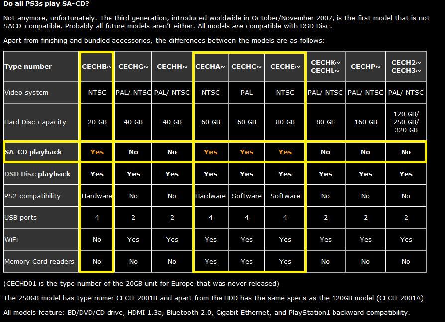

PM sent.  Firmware is user-updatable and not associated with serial numbers, etc.  But only four models of PS3 (all older) are eligible, regardless.  i've posted this before, but here it is again:
