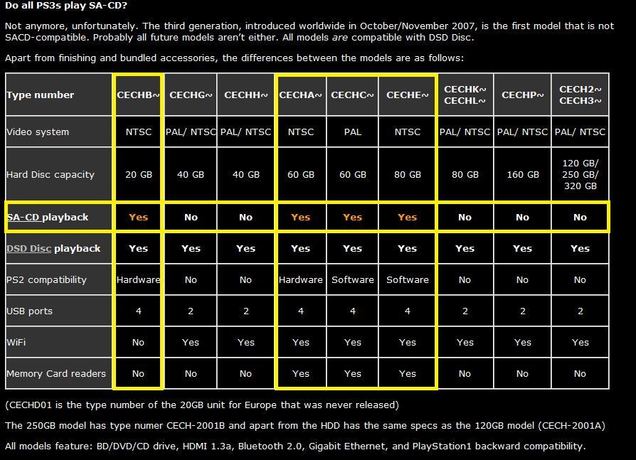

The ripper is only for the four models of PS3, period.  Sorry.

I wouldn't trust anyone to "rollback to 3.55" as it requires soldering, a hardware board swap, etc.  Yes, MR Wicked more than hinted that 2013 would be the year we would see an opening up of the restriction, but I am not holding my breath.
The ONLY four models that are even eligible (at 3.55 and below, of course) are NOT new PS3's, guys.  You need a model that plays SACDs first off.  :)  I have said that many times here (the most recent being like four posts up!). The latest produced second gen PS3 was early 2007 I think.  Here, again, are the models (in yellow):
