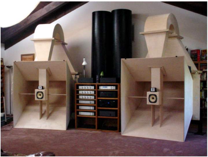

The Kleinhorn is probably the most extreme backhorn one could imagine, and it cannot achieve 20 hz to 20K hz.  See:
http://www.passdiy.com/pdf/KleinHorn2.pdf
Retsel
Retsel
This is my favorite example of what tends to happen when an audiophile is let loose with zero moderating effect by significant other or neighbor!
Æ
  • Posts: 859
Re: How does a single driver do 20-20,000 hz?
« Reply #18 on: 21 Mar 2012, 12:17 am »
Is that a ribbon tweeter I see? Well, if it is, then technically it isn't a 1 way system
doug s.
  • Posts: 6572
  • makin' music
« Reply #19 on: 21 Mar 2012, 01:07 am »
if i am not mistaken, that's a 3-way system - those black tubes are subwoofers, me-thinks.  personally, being more interested in results than being a "purist", when it comes to full-range speakers, i see nothing wrong w/this type of "3-way" speaker.
doug s.
