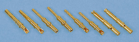

« Reply #28 on: 29 Jun 2005, 06:01 pm »
Hello all, gk1 is working fitfully now, a bit of work and the she'll be fine.
I just wanted to know if anyone knows where I could buy female equivalents (sockets) of the pcb pins, this would make my life easier as I seem to spend a lot of time soldering, desoldering etc and these sockets would be useful in the assembly stage and could be soldered permanently once everything is working and in a case.
Cheers
Nick.

« Reply #29 on: 29 Jun 2005, 07:11 pm »
Nick,
If the pcb pins you're referring to are the same as on the Aksa amps, the removeable female sockets used in many computer connections, DB9/12/25 connecters work quite well. The male pins used in these DB connectors are 1mm round, which are quite similar to the pins that Hugh uses.
http://www.rsaustralia.com/
simply do a search on 'd socket'
FWIW

« Reply #31 on: 30 Jun 2005, 05:26 am »
Nick,
Paul's suggestion is right on the money, I have used them, but you may have to sleeve them with shrink tubing to have some insulator around them and to  make it more rigid some of the socket comes with a slit and they are a bit, I would say fragile as they are ment to be used with the D shell housing.
cheers

Quote from: Rom
Nick,
cheers
Rom
BRILLIANT suggestion, Rom ... to put heatshrink round the socket!   :D
I have been using RS "pin sockets" for a while but was always concerned about the "grippy-ness" of the sockets.  With heatshrink, there will be absolutely nooooo problems!
Andy
