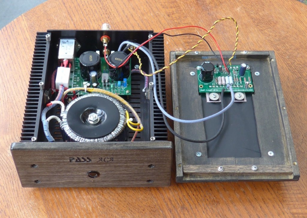

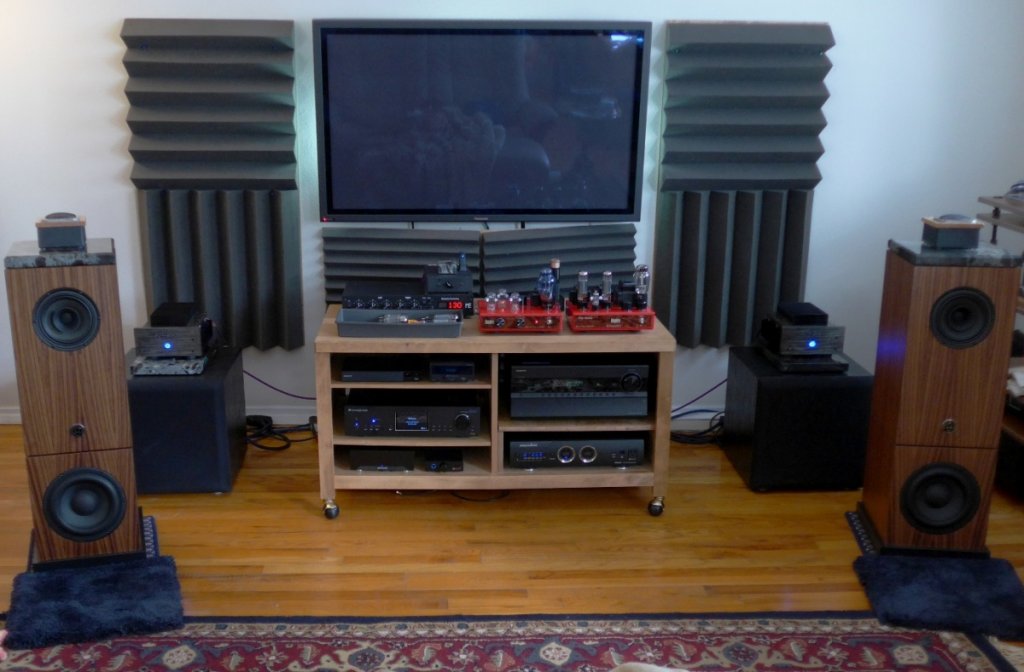

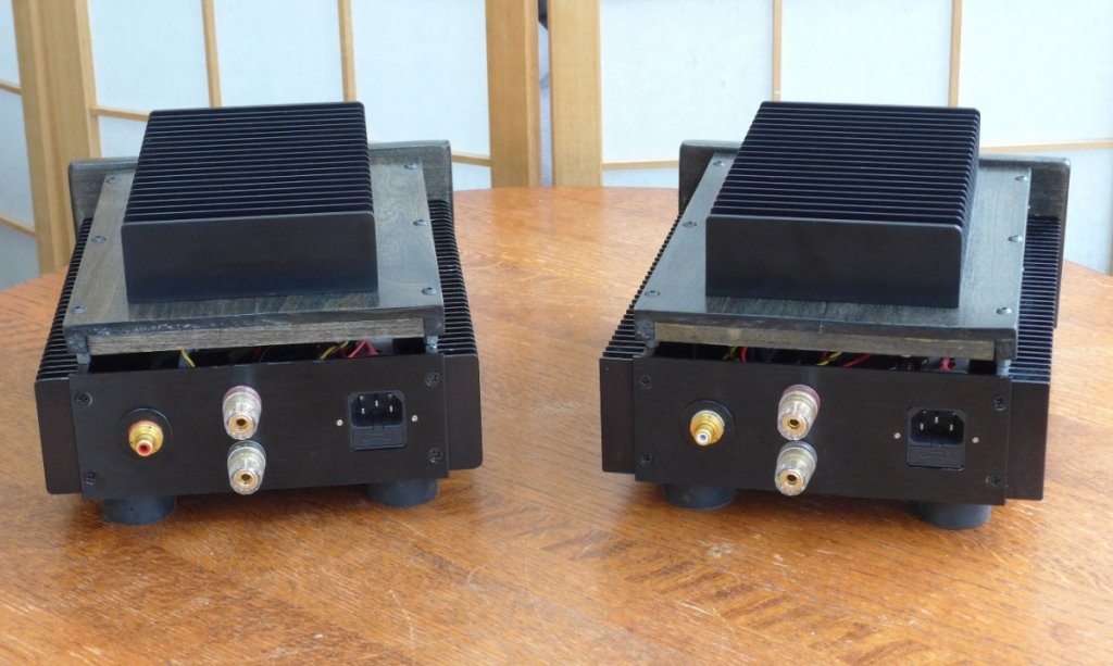

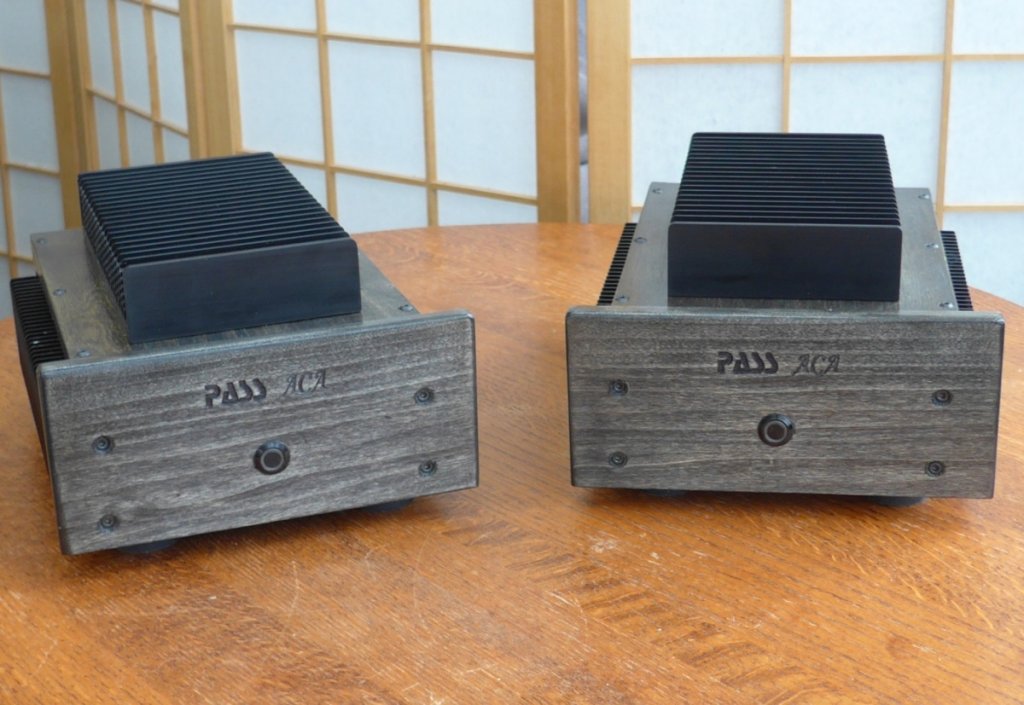

I will pop this post in here since we are talking about First Watt and Omegas.
I just finished a build of the Pass ACA "Amp Camp Amp".  the diyAudio store has kits for pretty cheap.  They are a pair of all Class A 8w monoblocs with a very simple circuit designed by Nelson Pass.  The kit comes with cheap 19v switching power supplies (like for powering a laptop).  On the build thread, there was talk that upping the DC voltage to 24v was an improvement, and it was even with cheap 24v switchers.  I was enamoured enough with the sound to order a pair of linear, torroidal power supplies in nice metal cases with heat sinks.  Sure enough, even better.  To my suprise, these became keepers rather than a fun experiment.  But I now had four chassis.  So I did a build based on the power supply chassis to accommodate the amp stage (a small board).  Added a heat sink on the top and used poplar wood stained ebony for the modified chassis shape and size.
I imagine this is a flavor of what First Watt offers and I may have to try the J2 at some point.  For now, I'm really enjoying these.  They are an excellent match with the SAMs.  I am feeding them with the Inspire LP-2 preamp.
.......Peter

Contrary to what my post might convey, I really don't know what I'm doing electronically.  I followed directions, got some advice on the diy ACA thread and it turned out well.  Might be a touch of luck involved too!
I've looked at some of the other projects including preamps and other amps, but they all look rather daunting to me!
If you do go for the ACA, consider going the 24v route even if with less expensive power supplies.  In fact, I have a pair of inexpensive 24v switching supplies that I would send to you for postage if you were to use them.
I think you are aware that I use a DECWare switch to switch between preamps using the same amp and speakers for HT and music.  If I didn't already have the LP-2, I might not be doing that.  But with a good 2-channel pre on board already, it was preferable to me to add the switch.

VERY COOL Peter... am I understanding it correctly that the two chassis pictured are what the 24v power supplies came installed in?  The chassis, interior assembly and wood exterior all look positively amazing!
I'll read through the Bride of Zen preamp information and see if I can muster the courage to attempt that project :o
