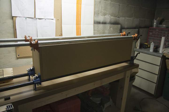

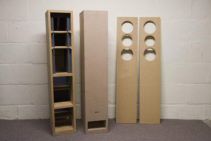

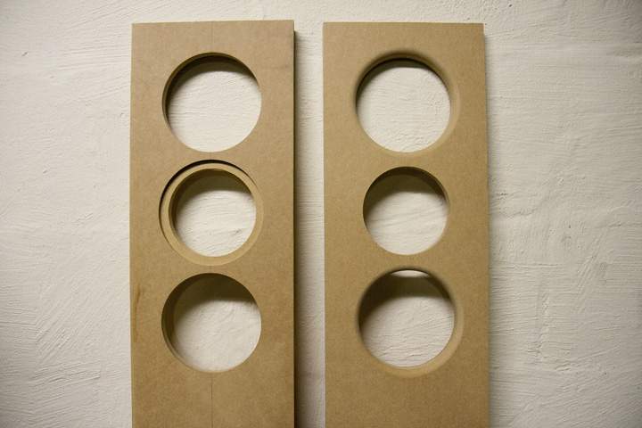

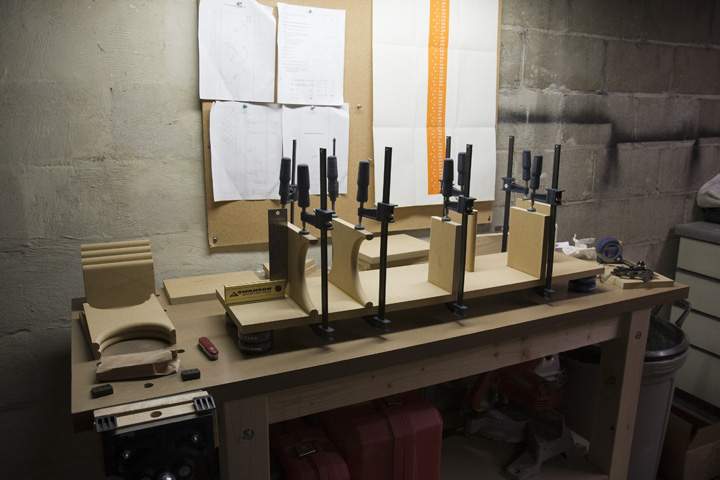

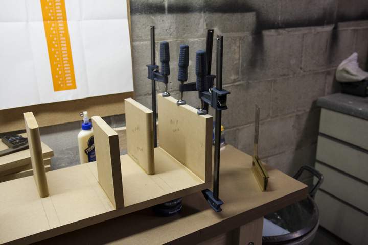

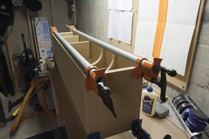

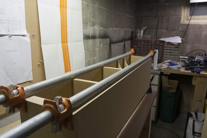

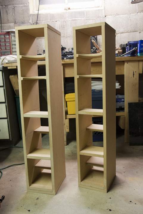

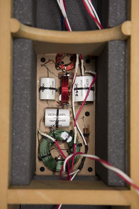

I'm getting close to finishing the build of my N3 towers, so I thought I'd share a few photos of the process so far.  It's required patience and focus, and I'm pleased with how the construction has progressed .  Comments and useful criticism are welcome, and if you see something that I've really messed up on, by all means speak up. Thanks.

Nice build pics.
Those are going to be tight indeed. :thumb:
Man I wish we had basements out west. Cool and dry, nice place to glue MDF.

Yeah, nice job.
I wish I had all of those clamps.  :D
bprochford
Re: My N3 Build, WITH PHOTOS
« Reply #3 on: 6 May 2011, 11:05 pm »
The 12" clamps are cheapies from Harbor Freight (like four bucks apiece), and for this project, they got the job done perfectly.  A nice set of Besseys would be great but I'll have to build a few more pieces of nice furniture before I can justify the price.  Buy 'em as you need 'em, right? :D

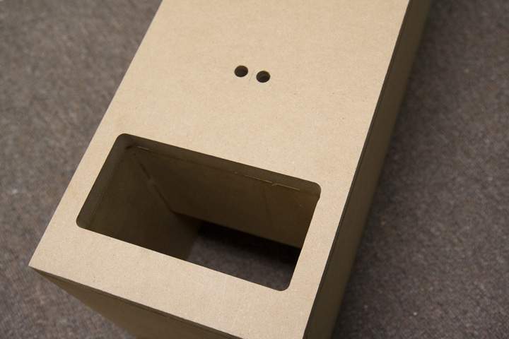

Not sure the round corners on the rear port will have any effects. I'd further cut to a straight corner using a jig saw.
I used a flush trim bit to cut the rear ports, thus the curved corners.  If I veneer the inside of the port, then I'll cut the corners square, so the veneer will lay flat.  If I paint the insides of the ports, then I'll leave the corners curved.  I don't so much mind the look.

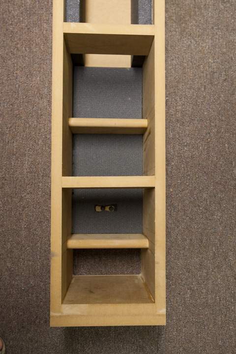

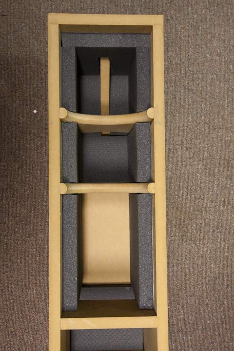

One quick tip on my build:  I found a great way to cut No Rez that seriously worked like a charm.  I don't have a table saw, which certainly would have made the process pretty straight forward, and I was a bit leery of using my circular or jig saw.
So, I used a heavy straight edge (I have a 1/4" thick piece of aluminum about 2 feet long) and a utility knife with a brand new blade to cut just through the asphalt layer on the No Rez.  Then, I used a serrated bread knife to slice through the foam.  Make repeated scores on the damping layer until you get a clean cut all the way through.  Then, fit the bread knife in the cut and slowly slice back and forth until you get through the foam.  It will help to do this on a surface you don't mind marring up a bit - I used an old piece of thin mdf board.
The cuts are clean and straight, with none of the choppiness and pull out you get when trying to do this with just a utility knife.  Make sure you use a heavier straight edge as the  smooth paper backing on the No Rez is wicked slippery, and you don't want the knife to slip because your straight edge moved.
Hope this is of use to the next guy without a table saw.

One question.  Did you use biscuits on the internal braces or butt them?
Just butt joints, clamped and glued.  Strong as a house.  If there were minor misalignments where pieces met, they were easily fixed with a flush trim bit and a block plane.

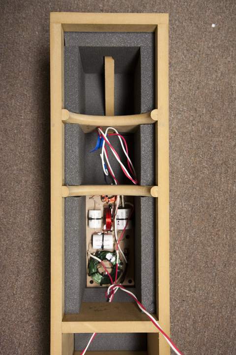

I'm getting ready to glue the front panels on my N3s, and I have a question before I close 'em up.  Do I need to somehow secure, to the inside of the cabinet, the cables running from the speaker inputs to the crossover, or is it sufficient to let them hang freely?
Also, does anyone have any favorites w/r/t acoustic stuffing?  Is AcouStuff really better than fiberglass (ithcy, no thanks) or standard poly stuffing?  Any feedback would be appreciated.

Brad,
  You don't need to secure the wires going from the crossovers to the speaker inputs. Just let them hang free.
 I have used both Acousti-Stuf and Poly Fil. Acousti-Stuf works well but can make the bass sound a little over damped if you use too much. I normally just lightly fill the area behind the woofers and tweeter with Poly-Fil which works just fine. Also, I always cover the interior walls with No-Rez too.
