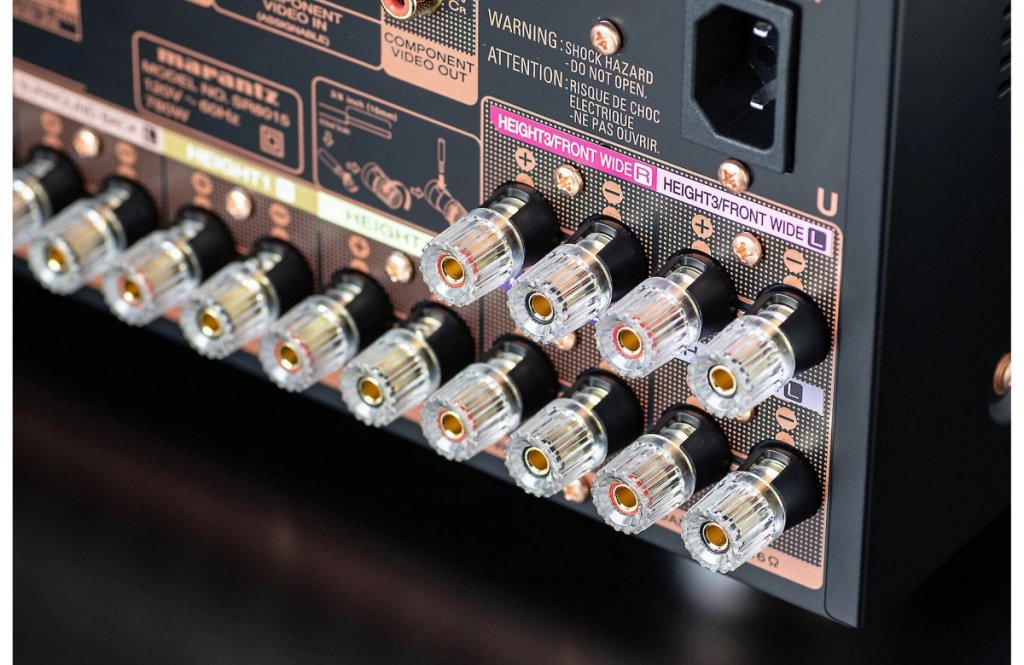

Hi Danny, are tube connectors compatible with the type of outputs featured in these pics (Marantz SR8015)?
corndog71
  • Posts: 1790
  • Some people call me Rob.
Re: Electra tube connector installation instructions.
« Reply #62 on: 11 Jan 2021, 05:42 pm »
Male tube connectors will fit into traditional binding posts but are slightly smaller and therefore can fall out if the cable is bumped.  I still use them.
Male tube connectors are very snug in the female tube connectors.
Danny Richie
« Reply #63 on: 11 Jan 2021, 05:58 pm »
The male ends are really only designed to work with the female tube connectors.

If you refer to the photo of the marantz amplifier, the black connector protector/guide prevents spades from being able to be used on most all marantz or denon amplifiers and receivers. I found bare wire to be not only brutish but not good for adjustments. So far, besides tube connectors, the best banana plug I’ve found so far are rhodium plated solid silver, low mass, and can be crimped and soldered to bare wire. These sound the best of any banana or plug I’ve ever used.

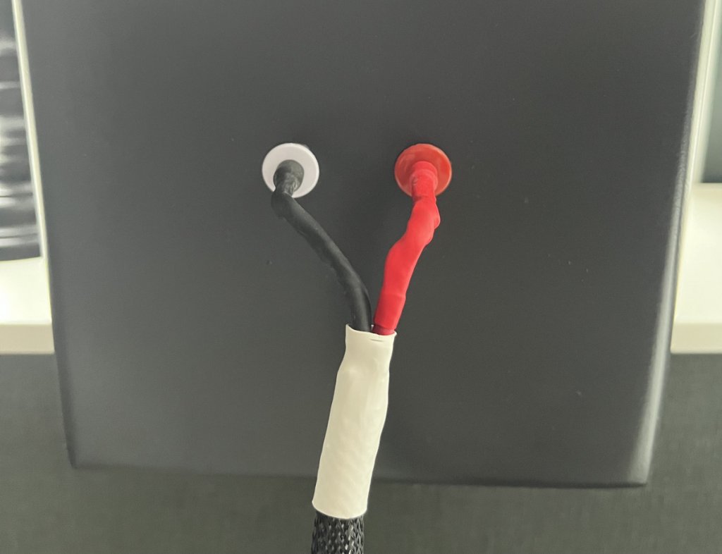

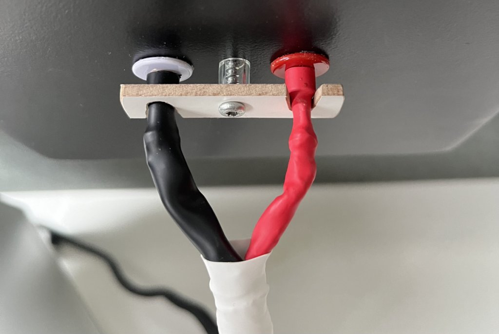

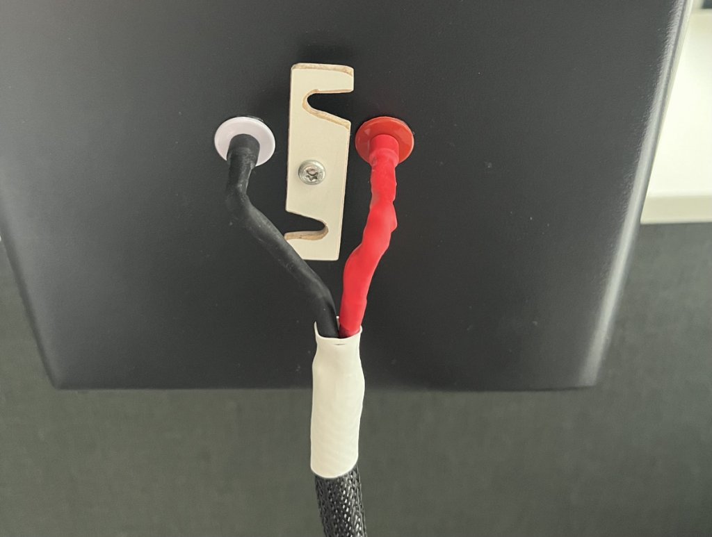

Loose Tube Connectors?
I move my speakers and stands out from wall and out in the room every time that wifey is away and I can do some great listening. Standing by the wall for casual listening.
Some of the connectors want to slide out a bit and even after I poke a little on the connector, bending the outer part of the hole, they do want to slide anyway.
So I made a piece of HDF as bracket with a stainless screw.
Now they stay put.
KTS
« Reply #75 on: 6 Nov 2023, 02:23 am »
Nice tweak!
