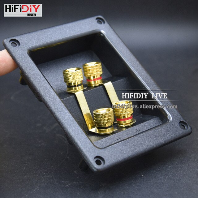

Hi Danny, Can I use Tube connectors on a bi-wired/ bi-amped speaker - normally there are Two sets of binding posts , one set above the other... and when not bi-amping , or bi-wiring , there is just a set of wires I made that connect the bottom set of posts to the top set of posts.... But I'm not sure how you could do it with tube connectors??

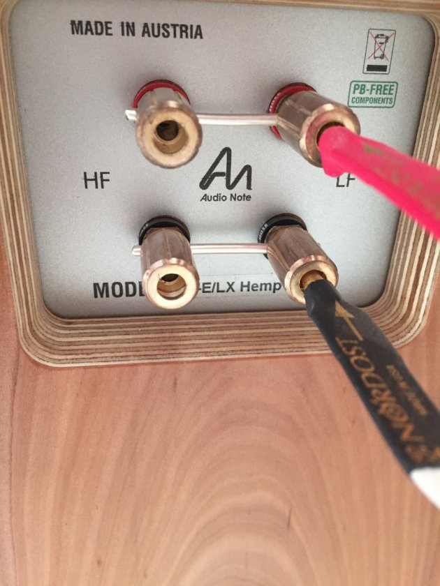

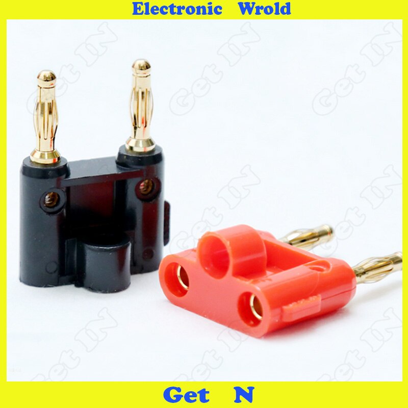

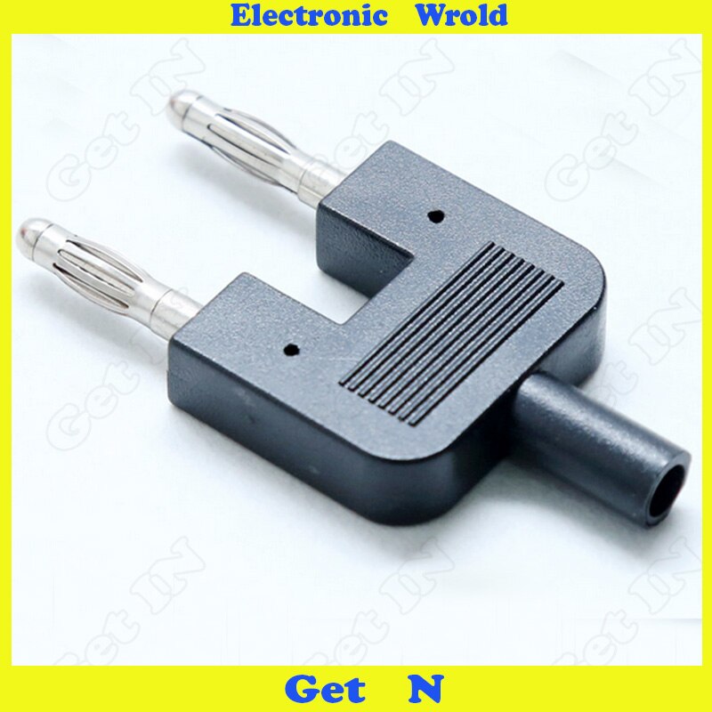

hallcon83
Re: Electra tube connector installation instructions.
« Reply #53 on: 25 Oct 2020, 03:28 pm »
Hi, what I don't understand is how you would connect the top and the bottom set of tube connectors together if you are just running one amplifier - the male ends would need to either have a 45 degree entrance or allow a second set of connectors to slide into the back of them, So you could loop the wire to the second set of tube connectors ....  ( please see other examples below )
so I usually use a bare wire on a 5 way binding post -
other people use a Bar connector -
Here are some examples for Banana type connectors ---
these use a 45 degree attachment point
Klei stacks their connectors
1 -
2 -
here are two other ways some do it ...
1 -
2 -
Any ideas - thank you

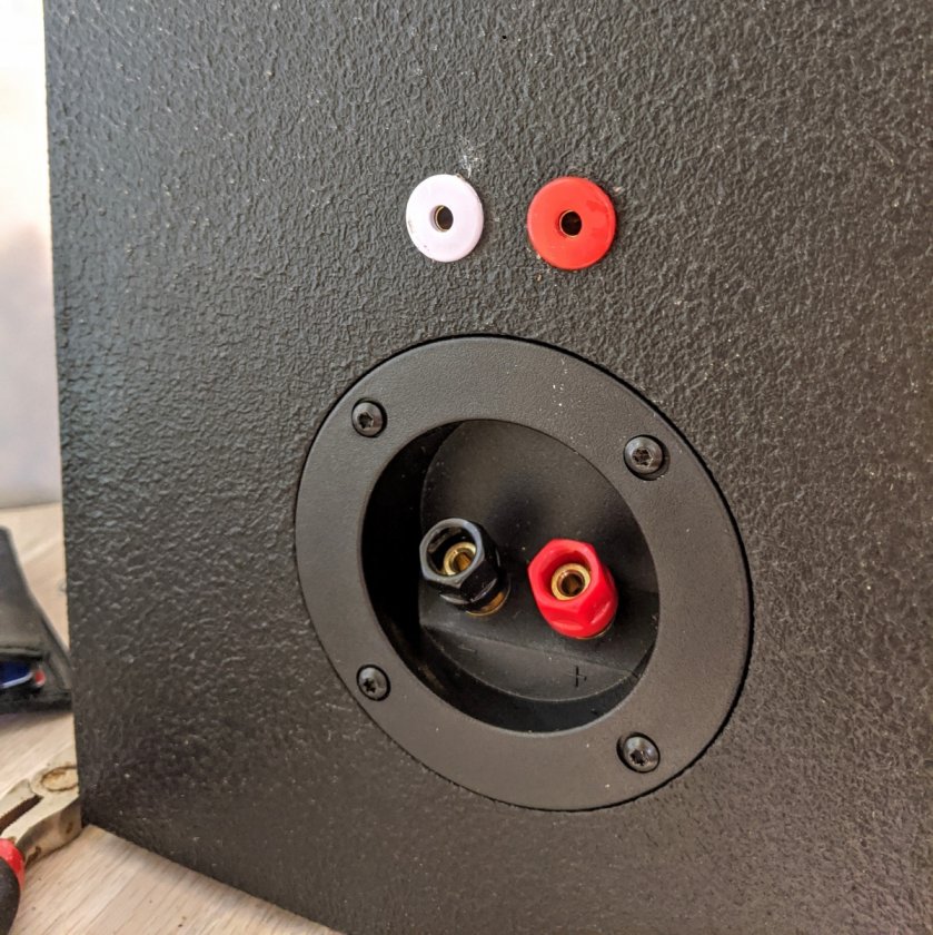

Assuming you don't plan to ever bi-wire/bi-amp:
You can leave one set stock, and replace the other with tube connectors.
Then on the inside, you have both sets of crossovers & binding post cables all twisted together feeding into the tube connectors.
That way there's no need for the extra connections, and you can A-B both connectors to hear the differences directly.
I did something similar with my XLS tho they're not bi-wire capable, but the process works the same, but just replacing one pair rather than drilling new holes.
Hope that makes sense!  :thumb:

Ah okay that definitely changes some things & I think the solution depends on your cables.
You would have to replace all 4 posts with tube connectors, and depending on your cables, have them terminate into forked ends, or like one of your above examples, have a smaller cable coming from the main connection, & terminating into the 2nd set of connectors.
It just depends on how willing you are to mod both your speakers and cables.
